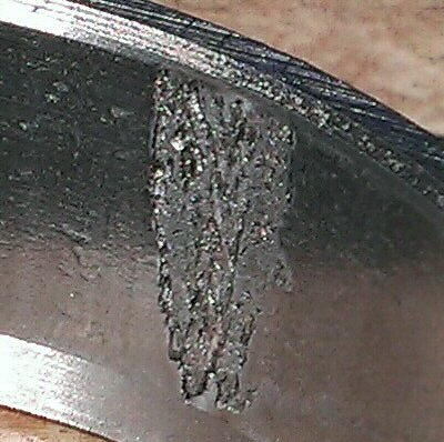

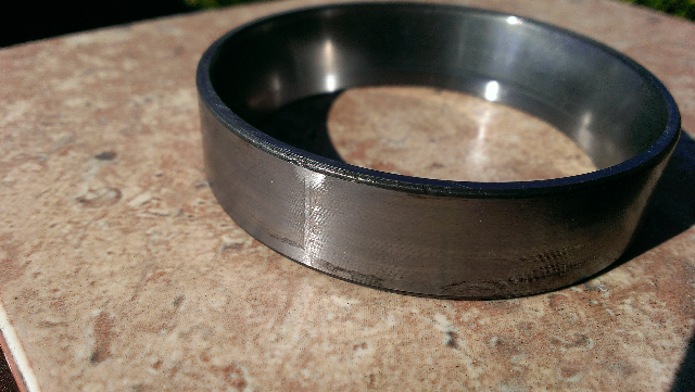

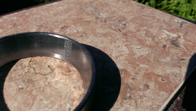

The Dana 44 torque is almost 2X the Dana 30 torque. I wonder, if they had done that, if some threads would have been stripped. Although, the bolts are the same size, according to the parts book. That kind of eliminates an over-torque issue.
A possibility is the caps were not installed in their original positions; left and right, and/or top and bottom.
Are the marks on the inside and outside of the race in line with each other?
Is the mark on the inside rough?
