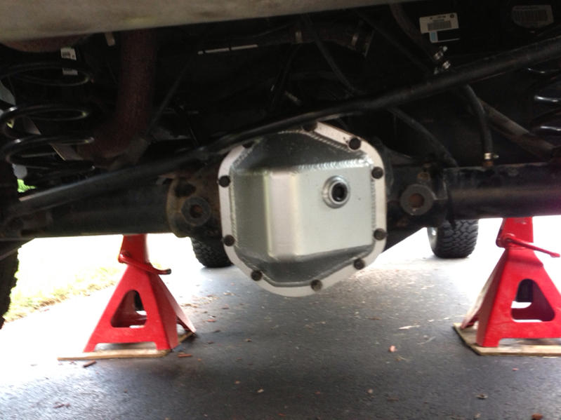

Originally Posted by Tripletsi
TeraFlex front and rear heavy duty differential covers, no problems with stock components.
<img src="https://www.jk-forum.com/forums/attachment.php?attachmentid=476598"/>
<img src="https://www.jk-forum.com/forums/attachment.php?attachmentid=476599"/>
X2 with Terra flex

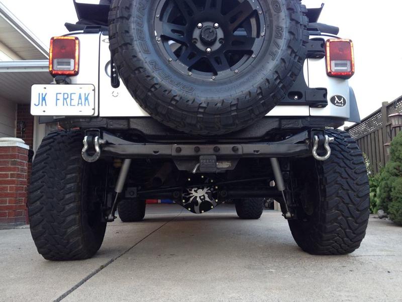

Originally Posted by TRAUMAhead
Anybody running Ruff Stuff/River Raider/BTF style covers?
I've got ruff stuff covers front and back - no rubbing that I know of. And taken it off road since I put them on.
Stock trackbars, 2" aev spacer lift.
