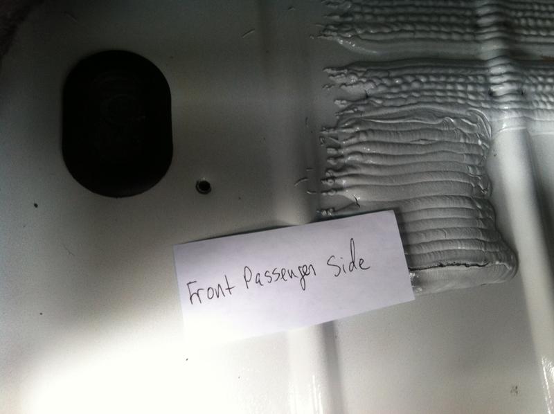

Doors and Panels Leak
2 Attachment(s)
I am having the same problems with both front doors leaking. The dealer tried fixing it and during the process somehow created a leak in my driver side panel which now collects water every time it rains, and the water drains out of the front clamp above and onto the media center.
We got rain last night and I went to wipe up remaining water on the driver and passenger side floors. Lifted the carpet and I noticed that there were holes drilled into the floor to drain the water...looks like a quick fix the dealer had tried to drain the water without me knowing about it. Can anyone confirm that there are only the plugs on the floors for water drainage, not regular drilled holes...I don't recall seeing drilled holes in the floors like this. I am livid about this!!!
Thanks for any input...
Attachment 550545Attachment 550546
