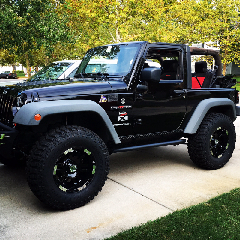

I have the exact same lift, but I strongly recommend 315/70/17. And regear to 4.56. You will love it. I did Duratracs. 285's may seem small, especially on an Unlimited. Here's mine as a thought for you

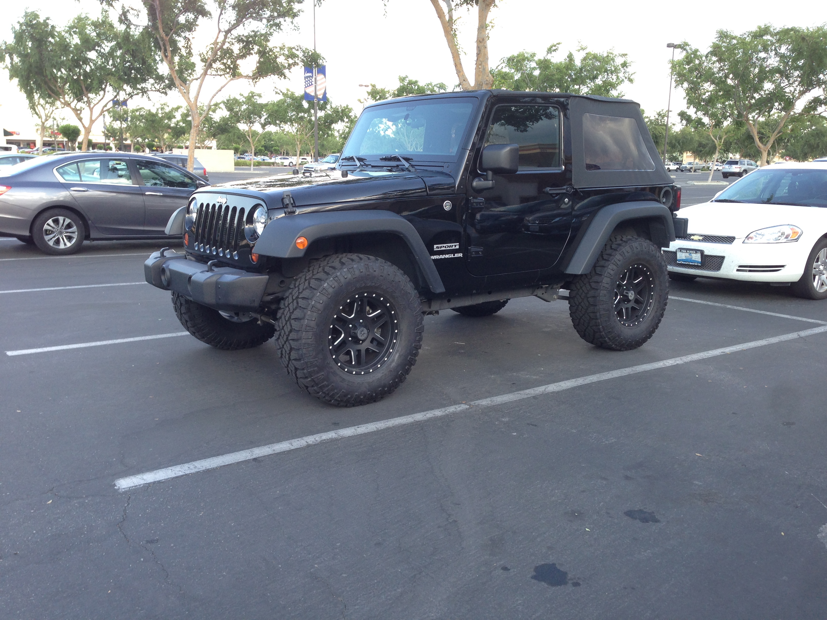

Cooper Discovery. STT Pro LT315/70R17 in case you wanted another choice/option
Attachment 660884
These are very quiet and ride nice!
Attachment 660884
