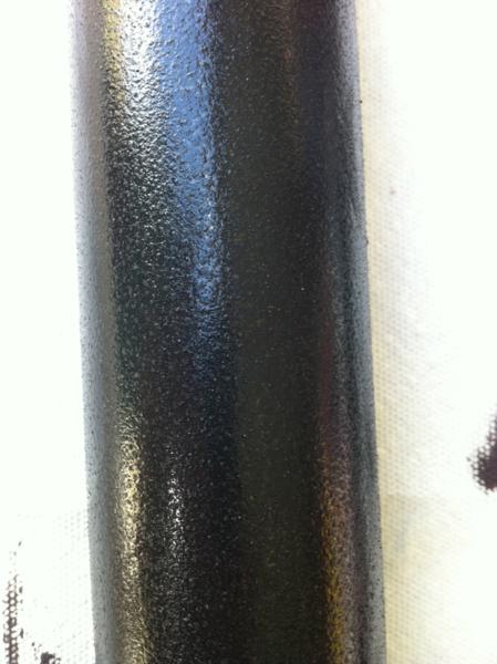

I bought the MBRP lightbar and in an attempt to protect it from the elements I decided to give it a coat of Duplicolors Bed Armor. I gave the part three coats of the roll on stuff but I hated the results so much that I stripped the part down to bare metal. The coating was just to coarse and inconsistent in texture for my liking. So this leads me to ask the following questions;
1. Does the aerosol bed armor have a smoother more consistent texture when applied?
2. How UV resistent is this stuff? I'd hate to put in all this work to only have the finish last several months before looking old and dull

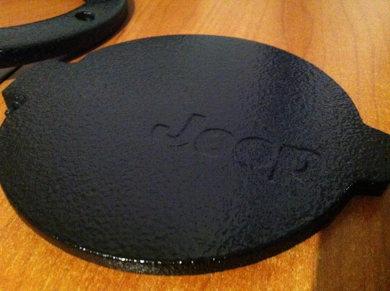

This was my test piece to make sure the CC would adhere well to the bedliner
Applied new coat of bedliner to the fuel door because it was faded pretty bad. Then hit it with 3 coats of Rust-Oleum Clear Gloss Lacquer

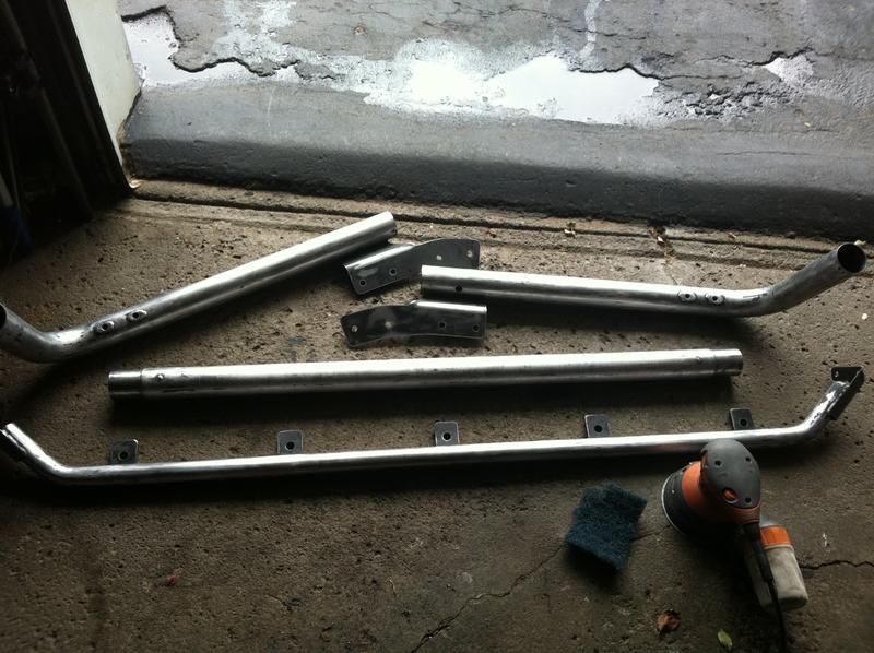

My progress on the MBRP lightbar
Stripped and sanded to remove the awful roll-on bed armor
Followed by 3 light coats of dupli color etching primer. Then 5-6 light coats of aerosol bed armor (much better flow and a nice even pattern) Pic looks a little dull though but it really turned out nice
