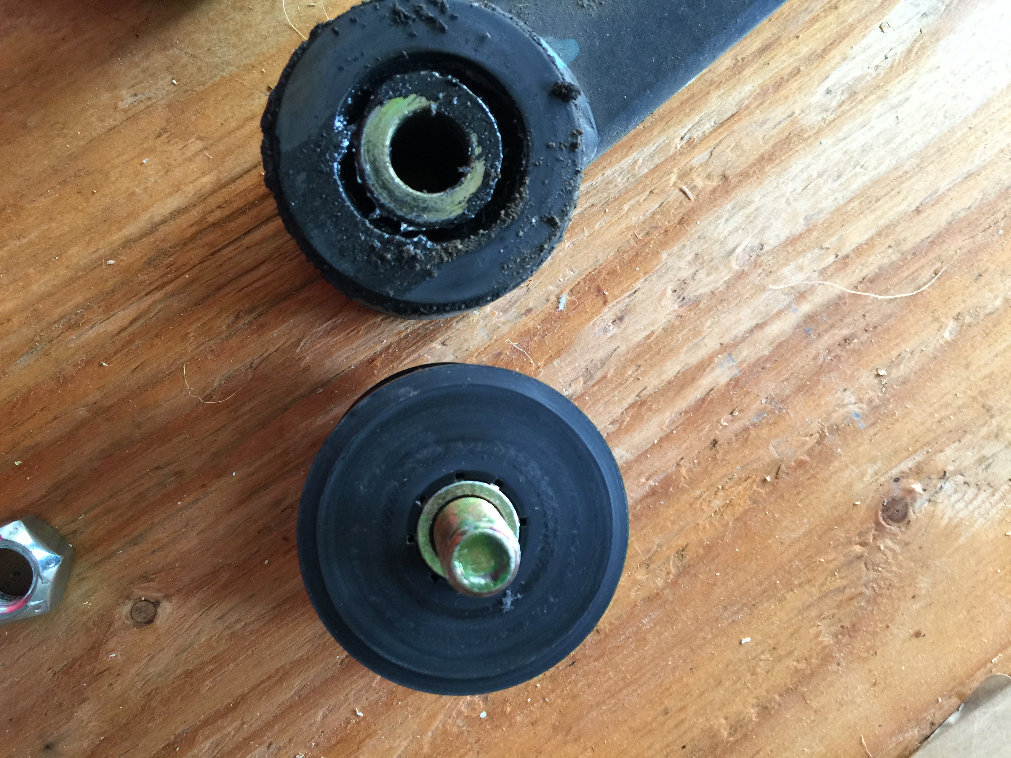

Thinking the Ball Joint replacement... If you are (going to go) with bigger tires... you might want to have some C gussets welded in at the same time. Maybe have a shop do it, so all you have to do is tackle the control arm issue.
I replaced my control arm bushings twice with the Energy Suspension from Quadratec. I kept wollowing them out, because of the shock travel I have. Every time I flexed it I'd get the shakes pretty bad after I got home. In Picture, the lower bushing is new. Think I used the oem bushing mentioned above for the upper front axle.
Energy Suspension 2.3108G - Energy Suspension Front Control Arm Bushings for 07-16 Jeep® Wrangler & Wrangler Unlimited JK - Quadratec
