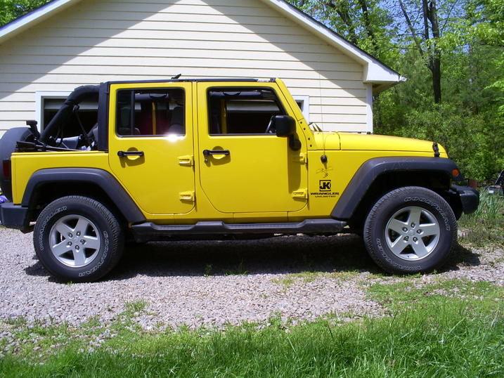

I've done exactly that. Daystar 1.75 with no factory spacer. No problems and drives like stock. It's about .25" from level but way better than it was. With the factory spacer it was sitting too nose-high.
