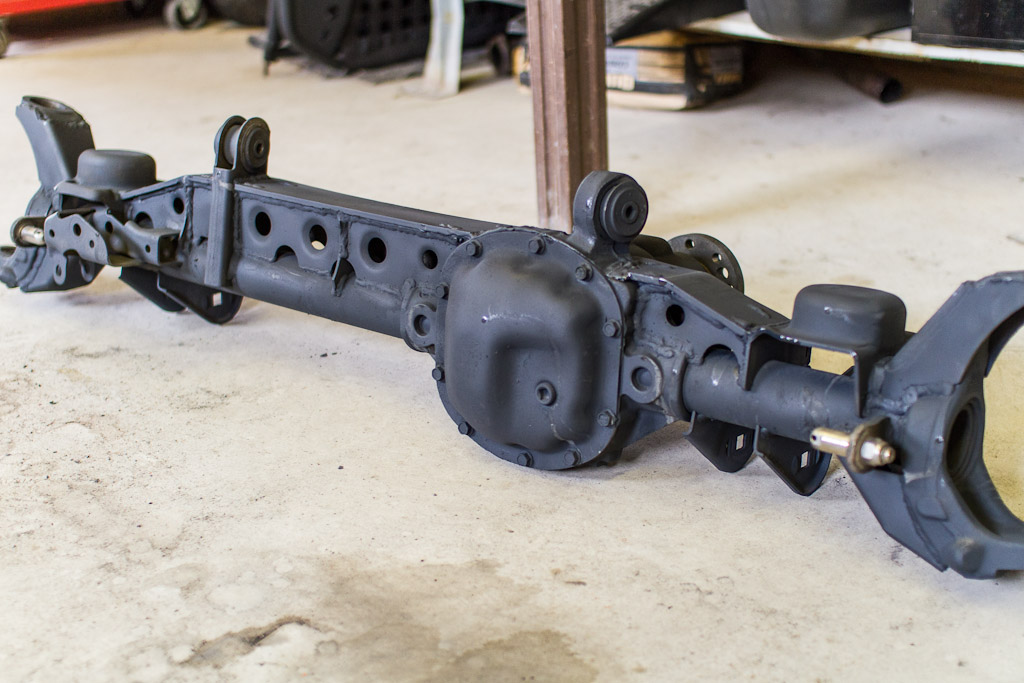

Hey guys, so i have a situation with my front Rubi D44. Specs - 2dr 2014 Rubicon, Manual, tube/flat fenderers, 1 - 1.5" lift on front - (JKUR Unlimited Takeoff Springs). I'm am running 37s, well putting them on tomorrow. I want to make sure my front axle is trail worthy, light to medium difficulty... and of course difficult at times when it comes up. Going to be running Ten Factory 4340 Chromoly Shafts in the front, but i also want to Truss the font with the Artec Artec JK Front Axle ARMOR KIT. That would be the ideal situation.. i think anyway. I am not sure that i will have the clearance for the Truss though. If i were to just Gusset the inner Cs and Sleeve the front would that but sufficiet for running the 37s? Jeep is going to be offroad at least a couple times a month, and i want it to hold up the best i can with my front 44. Any help with this situion would be great. Thanks

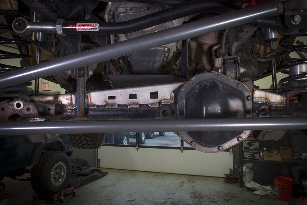

I run 37's on a rubi axle with artec gussets and synergy weld in sleeves, also synergy ball joints. I run medium to hard trails in my area, but don't hit the skinny pedal to get over obstacles very often.
Sleeves will not keep the axle from breaking, but for 100$ it is an easy piece of mind. I got my axles(front and rear) complete for 2k with lockers, then stripped them down for a complete rebuild. I put Artec front LCA brackets and front and rear track bar mounts. I have put a few rides on these axles at Stoney Lonesome and AOP with no issues so far. I ride with others running the same setup that drive a lot crazier than me, and have been doing so for a lot longer with no issues.
