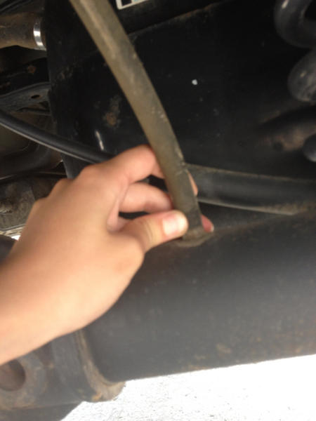

I haven't changed my gear oil. Recently I noticed that the breather tube wasn't on. Must have slipped off while wheeling...I placed it back ok as you can see.. Maye this was why?

Without actually hearing it, it's hard to suggest. I'm kind of leaning to throw out bearing but usually it's heard in take off and 1st to 2nd as well. I highly doubt the clutch before the throw out but anything is possible. I'd check your u-joints throughout prior to dumping any cash into a fix. Some people beat up the driveshaft u-joints pretty bad driving a manual (not pointing fingers). Just climb under the rig and give her a good look over. Also, check you diff fluid
