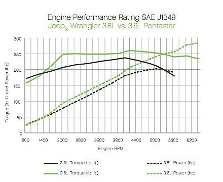

Well I strongly disagree with you about the 3.6L being garbage. You say it is "all numbers" and it is. But isn't every engine ever produced all about the numbers?
Here's the "numbers"
They don't lie and they are better vs the 3.8L in every possible way. An excellent move on Jeeps part.
In my personal experience, you can feel the torque when it starts coming in around 1,700 RPMS. It makes a difference.
<img src="https://www.jk-forum.com/forums/attachment.php?attachmentid=380356"/>
