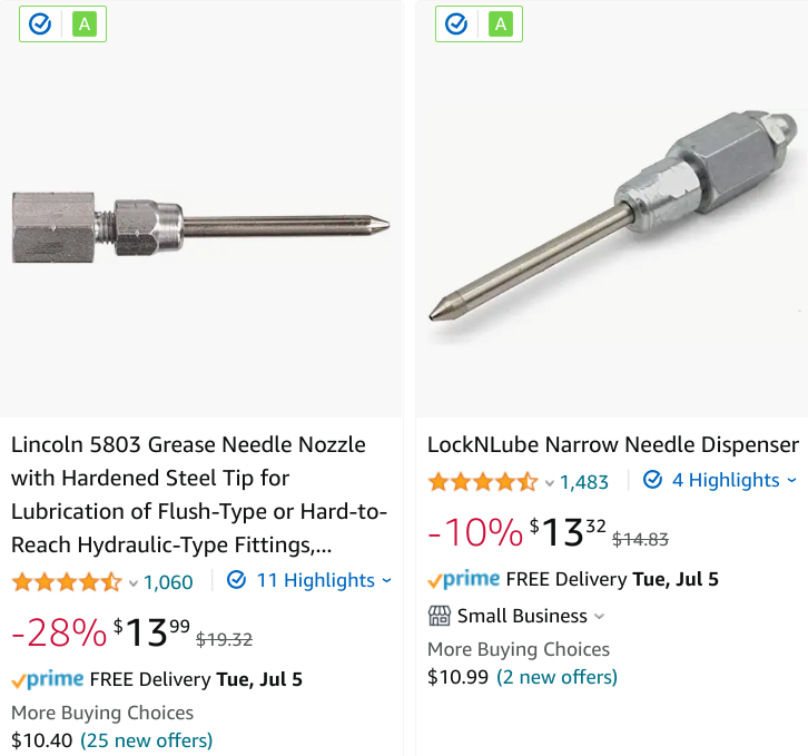

That little zerk is for the lower. i typically use a needle fitting to hit that one. Depending on what BJ you have, sometimes it is recessed a bit right below the axle shaft u-joint, and sometimes it is right below the bottom of the C. I've got a Lock N Lube on my grease gun so I use their needle here on the right, but good ole standard needing fitting in general works fine.

Nice thanks, I'll check to see how much clearance I have when I install them, I might end up grabbing that fitting. I don't want to publicly say what ball joints they are until I've run them for around 30k then I'll give them a review on here hahaha
