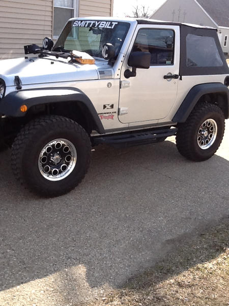

I dont do any serious trails but do alot of easy ones. I love my set up which is a rock krawler 2.5 stock mod lift with bilstein 5100 shocks. For tires i have good year duratracs 285/70/R17 and they do amazing in the snow.

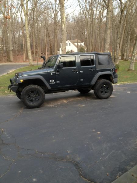

Love my budget boost!
