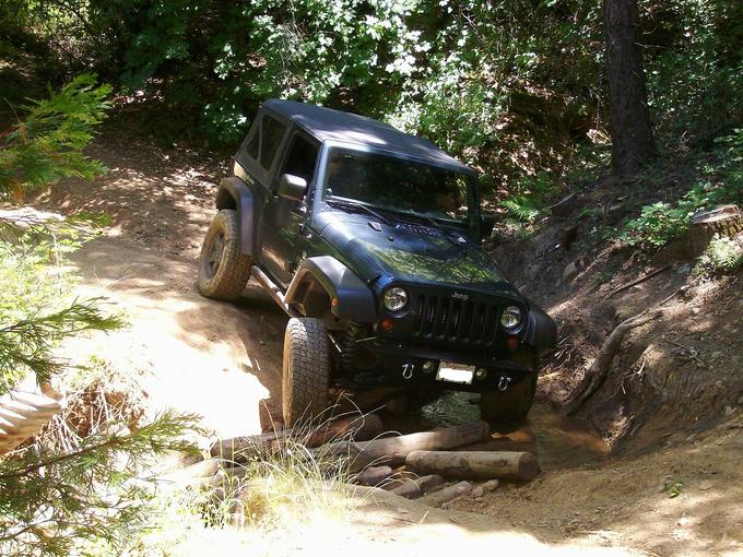

you'll be just fine with only the lift. I had this exact lift for a short period of time. Your lift height will be close to or under 2.5. RC coils sit @ 2.5" additional lift in front, 1.88" in the rear for a level stance. These coils settle a lot. My rear on my 2dr sagged so bad, two rings of the left coil were touching each other. Axles remained centered, lca's were not neccessary, nor were brake line exts or bump stops. From my experience this was a poor lift. old pics on 33's.
