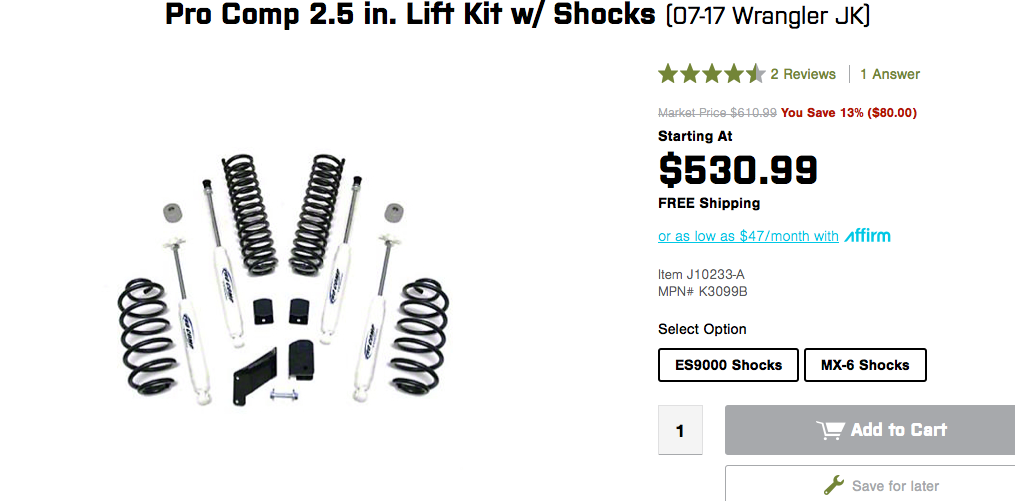

Your first issue is you went with a Pro Comp lift. Your 2nd issue is that the kit I'm betting is not complete thus your geometry and roll center is all out of whack.
This is what I'm assuming you're running or pretty close to it.....
* this pic is of the 2 door setup, but the 4 door kit doesn't look much different
Compare your Pro Comp kit to something like AEV's 2.5" suspension lift kit. Look to see what's missing and learn in the process by understanding how those missing components function to give the vehicle a better ride & driving ability.
Attachment 669226
Attachment 669226
What's wrong with pro comp
I added a bunch of stuff to the lift adjustable front and rear track bar
And I have that part from aev but mine is from rubicon express
What am I missing
Should I get lower control arms
