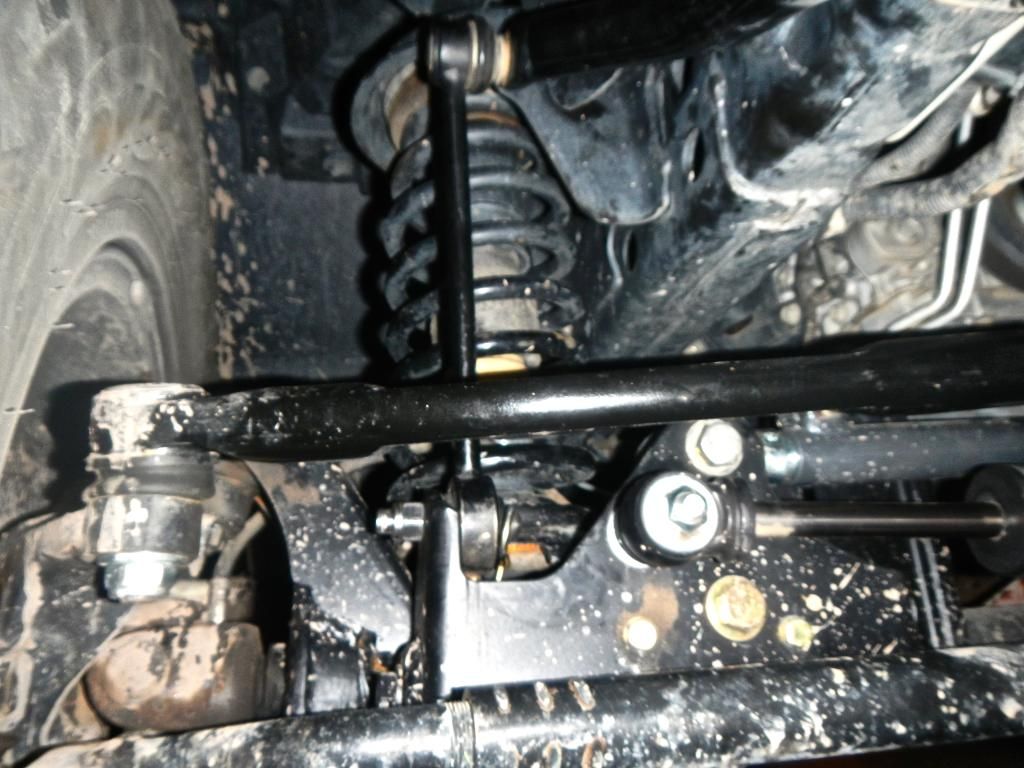

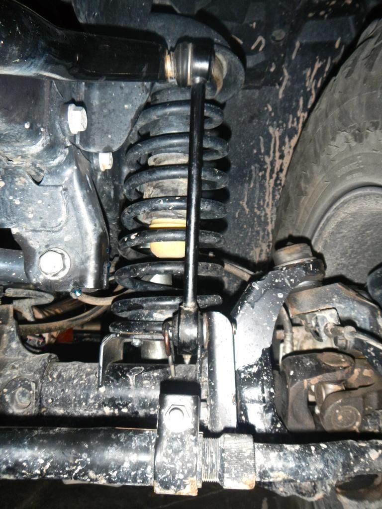

Posting these just to show how the links changed with the EVO Draglink Flip bracket. Only posted pics for a few replys that weren't sure about why the links ended up longer this is the passenger side Driver side
And I've decided again to leave them as is! And maybe I'll start disconnecting instead of using the button.
