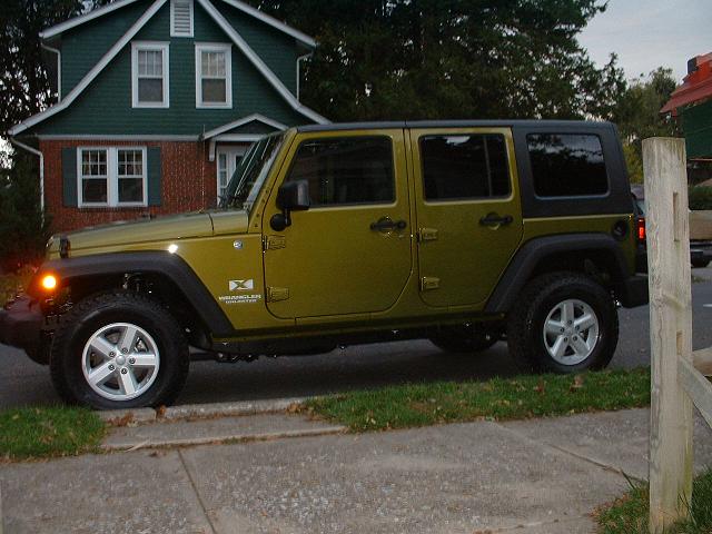

Without any lift, 32's max - trust me on this one. I just took photos and measurment of a rubicon yesterday to show all the areas that will rub if you go any larger. Need I say, there are a few areas that have about 1/2" to spare. I'll try to get these photos up soon.

What a tire says on the side walls is not the same as what its actual dimension are (usually much less). And, I should add that no two manufacturers of tires measure up the same either. For instance, a 33" BFG M/T hypothetically has an actual height of about 32.1" whereas a 33" TrXus M/T may have an actual height of about 32.5". Both have the exact same dimensions listed on the sidewalls but neither of them measure up to 33" nor do they measure up to the same height. If you don't believe me, go to a tire shop with a tape measure and test what I'm saying for yourself. Believe me, I've done it.
Having said all that, the Rubicon I saw the other day had its 32" BFG about 1/2" between the face of its tread and the plastic air dam at a full turn as show below:
Now, I'm not saying that a stated 33"+ tire couldn't fit without rubbing (as that would only be about 1/2" extra height total), but the actual dimensions of the tire make you buy will make a big difference.

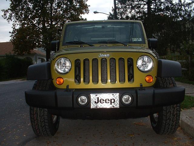

Wayoflife,......thx for all your input, I will be putting a 265/75/16 at 31.64" tall and I think safe. It's going to be the BFG T/A KM or Firestone Destination M/T. It'll make as big big change in the overall look of he JK. Again, thank you all for helping me big time..............

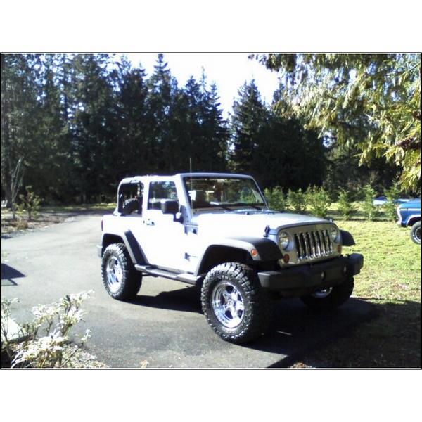

Wayoflife, Yes, he does have some rubbing, and right where you said would. I went a head and made the final decision on the Bridgestone Dueler A/T Revo 265/75/16 & had them insalled yesterday. WoW what a change, more ground clearance, and better overall look(balance) to my JK. Dove around town & at speed on highway(70+), fabulous performer, I think winter & those great mountain logging roads are going to be a blast. Can't wait.............
