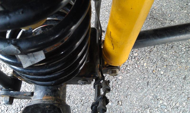

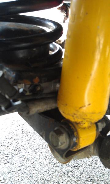

camera phone to the rescue
Name:	brake bracket.jpg
ID:	272952Click image for larger version
Name:	brake bracket 2.jpg
so thats the factory setup, so yeah. I just wasn't sure if I should reuse, or just toss it and let the lines freeball it
Attachment 272952Attachment 272953
okay, you were talking about the bracket under the spring perch. yeah, i believe jeep started doing this back in 2011. you don't need to route your new line like this but rather, just take it out and around the shock like was done in 2007-10

because I'm a tard I have to ask, I'm assuming on the rear side of the shock, not the spring side, correct? and removing the abs lines from the bracket and just zip tieing them to the brake lines is cool?
Old Feb 1, 2012 | 06:52 AM
wayoflife's Avatar
JK-Forum Founder
Joined: Jul 2006
Posts: 36,534
Likes: 16
From: Laguna Niguel, CA
yes, to the back of the shock, not between. also, you can re-route your abs line so that it drops down the back side of the frame rail and that will give it more length as well.
