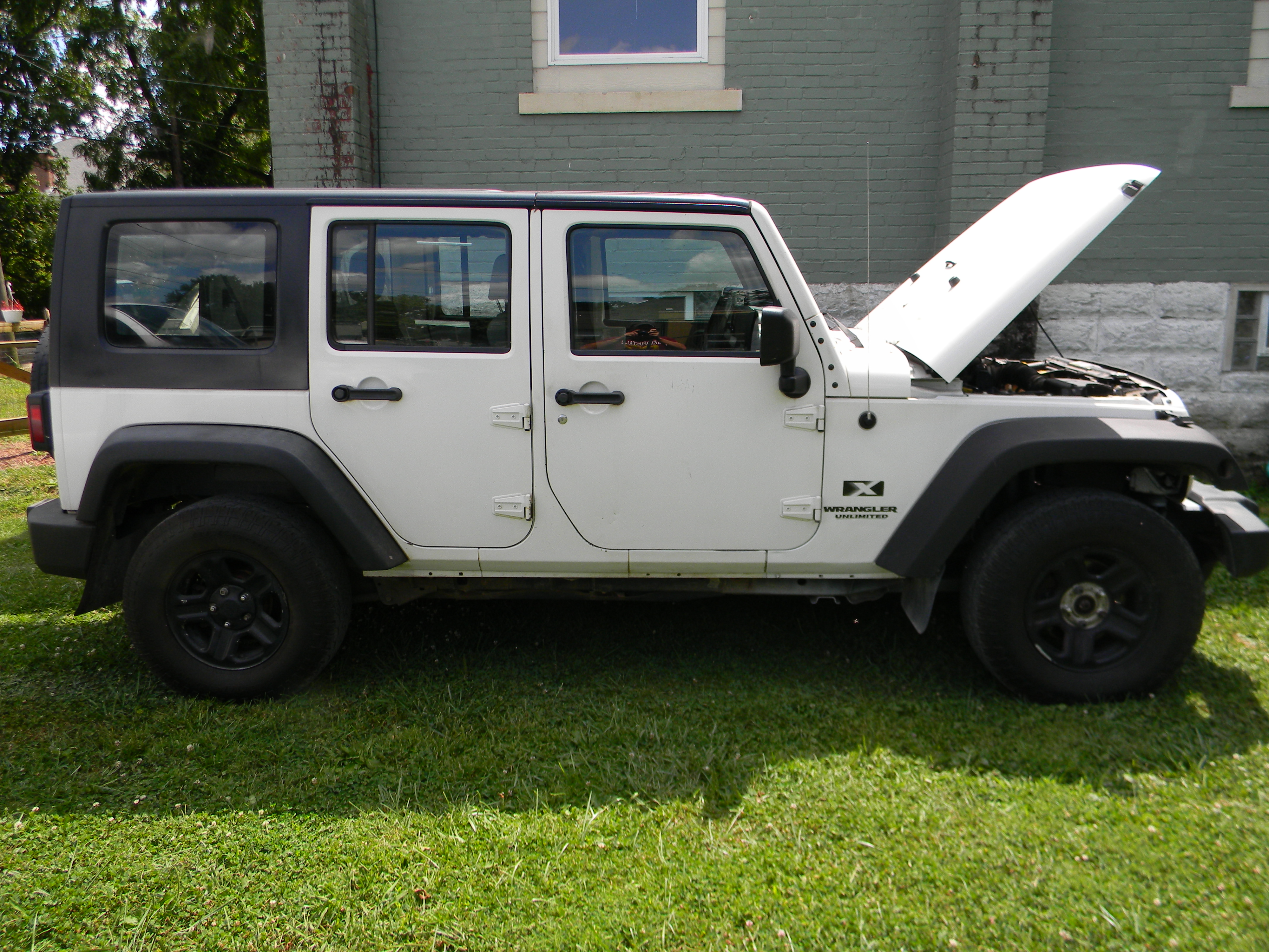

    New to the forum and long time Jeep owner but this is my first JK. 2009 JKU "right hand drive" for now. Picking it up tomorrow with a knocking engine. Only paying $7500 for it so I think that's a great deal. Very familiar with the 3.3/3.8 engines and I really like them. Some people don't and to each their own. I like the fact they are an iron block, center cam and use a timing chain instead of a belt. I've several caravans with 250K plus miles that ran fantastic.
    Ok so I haven't found any other detailed threads on using the 3.8 lonblock from a caravan for this swap. I love doing these type of threads with lots of pics so people can see the before and after and see what is needed. I'm going up to picapart to pull an engine from a Dodge grand caravan this next week. Out the door it will only cost me $225. I'm good with that. I will replace most of the acc with new parts while I have it out and easily accessible. I love keeping the price down so $500-$600 is what the budget is for this swap. Soon as the motor is in and everything is good I will do some other threads on a budget makeover including new wheels, tires, fenders, side steps and bumpers for under $1500. I will post pics and YT videos along the way. Feedback is welcome......try to keep it positive.
