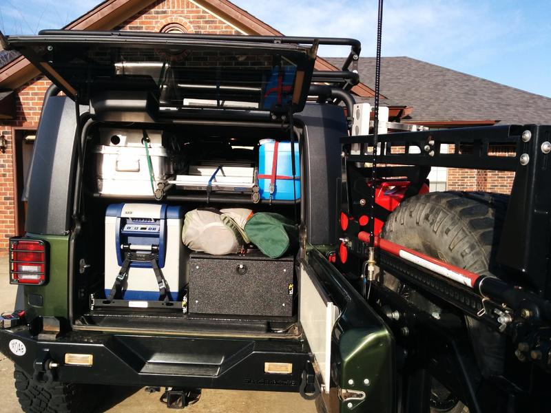

Wood is heavy. I opted for a drawer built by SoCal Trailers to my custom measurements. It and a Tembo Tusk fridge slide are mounted to a custom cut aluminum plate that has been Line-X'd and bolted to the JK cargo area. The rack is from Adventure Trailers. Honestly, I helped a fellow with a wood drawer system, and he ultimately went with the SoCal Trailers drawers to save weight (they are made of Fiberthane).

Yup, wood is very heavy for this purpose. My flight containers are resin and the doors aluminium. The only heavy part is the shelves which are wood. That said, you would construct a frame in fairly light wood and then use something like aluminium covered plastic sheeting to construct the sides and shelving.

https://www.jk-forum.com/forums/jk-w...torage-178549/ Maybe this thread? FYI I have a similar set up in my jeep and its not that heavy. People will strap 1000 lbs of steel on their jeep and call 35 lbs. of wood heavy. Gets me everytime.
