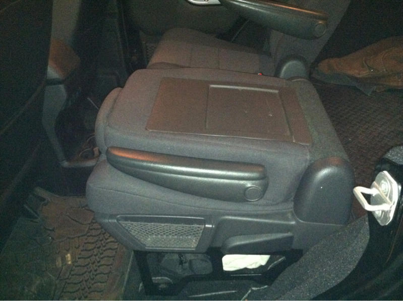

Has anyone here thought about putting two front seats in the rear on a JkU. I've always liked the captain's chairs better than a bench seat. I wonder if this is possible? Has anyone seen this? If anyone has pics post em up!
Not very difficult at all. I didn't use a set of front buckets, but there wouldn't have been much difference. It was an afternoon project, the key was using the mastercraft brackets to get it started.

I have two boys over 6ft tall and I wanted to spend more time as a family camping with the jeep. I tilted the bench back but it still sucked. We were headed to Colorado last year for a week of trail riding and camping (17 hour drive) so I had to do something different.
I found some seats out of a salvaged 2011 that the salvage yard could sell because the fabric was torn and dirty. I got them for almost nothing. They even had heaters! I welded up a bracket that would make use of the stock mounting holes and bolted the seats to the frame. I mounted them as close together as I could so they would fit between the wheel wells when they were slid all the way back. That gave the kids about 8 inches of extra room. It was actually more comfortable in the back than in the front!
I had leather seats up front and torn, dirty, faded seats in the back. Not pretty. I called Mitch at trek armor and had some seat covers made in black with tan stitching. Now they look freaking awesome. This set up looks factory and the covers are unbelievable! The seats will slid forward for more storage or back for leg room. They recline when you need a little down time and with the seat covers, they look fantastic.
