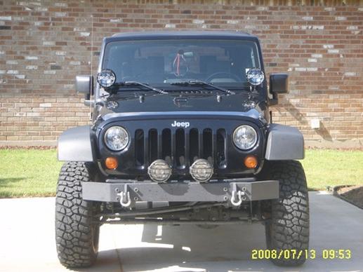

I just heard back from the guy who owns the Jeep who's picture i posted earlier. His KM2s (285/75 16) measure 10" wide section width and 7" wide tread mounted on a 16x8 wheel).
A Pro Comp Mud terrain in the same size has a tread width of 8.9" and a section with of 11.3". I'm not sure why but the KM 2's seem to be narrower across the board.
I've never seen any other size of this model tire in person... so it would be interesting for other KM2 owners to chime in on their tread width/tire size as BFG does not have tread width measurements on thier website. Now I think I know why.
