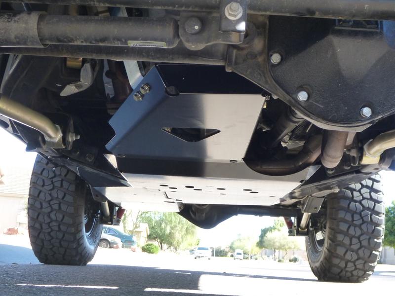

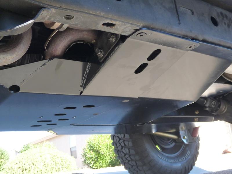

My JKUR has the EVO Protek system. I am okay with the oil pan mounting. The cross-member does have a weak spot and every set I've installed has needed some tweaking. I modified the weak spot with a gusset seen below:
Even though I have had to modify this system it is still what I personally prefer.
