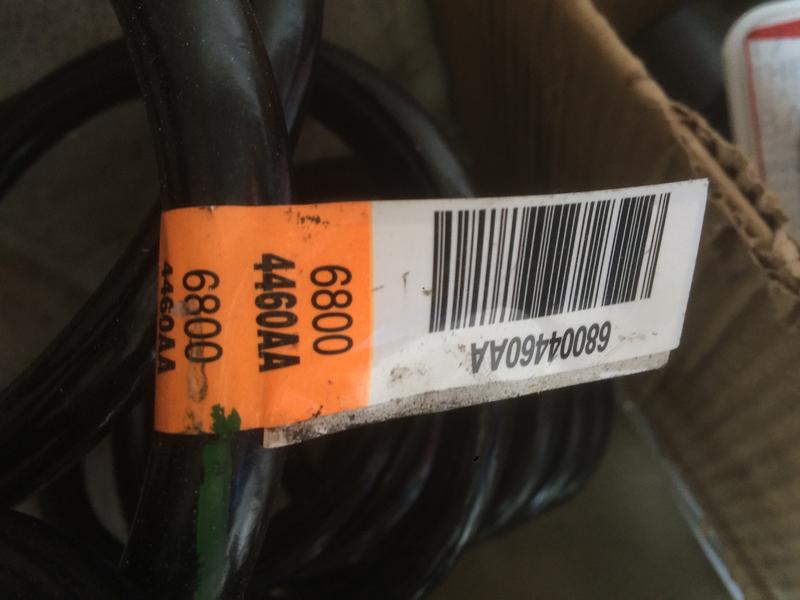

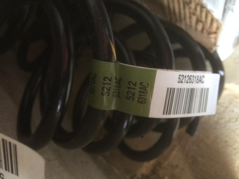

My buddy has a 2014 Unlimited Rubicon X and had the dealer put on a Mopar lift. He gave me his complete stock suspension. I am looking at a 2015 2door sport to wrench on, will the 2014 rubicon 4-door suspension parts work on a 2-door? I didn't know if the different spring ratings on a 4 door would make a difference. Any answers would be greatly appreciated.

the coils have tags with numbers followed by 2 letters what are the numbers? what are the numbers on yours? technically it is possible that they are identical to yours altho unlikely.

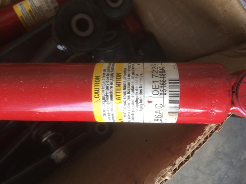

Old Jun 2, 2015 | 11:22 PM
JK1124's Avatar
Posts: 4
From: Cincinnati, OH
ID:	613440Click image for larger version
ID:	613441Click image for larger version
ID:	613442 @jadmt he also gave me control arms and bump stops, but i'm pretty sure those are standard throughout the modelsClick image for larger version
somehow this thread ended up being about an a/c i know i don't want since this is gonna be a weekend warrior, i have a RAM 1500 for when its 100 degrees; will these parts work?
Old Jun 3, 2015 | 03:05 AM
jadmt's Avatar
Posts: 4,364
Likes: 107
From: missoula,mt
Originally Posted by JK1124
Attachment 613440Attachment 613441Attachment 613442 @jadmt he also gave me control arms and bump stops, but i'm pretty sure those are standard throughout the modelsAttachment 613440Attachment 613441Attachment 613442
those will give you some lift depending on your spring numbers. 60 rears are about tops and 18's are too, 19 is the most in the front for non 10A/X jeeps. rubi shocks are an upgrade over sports and you are correct the control arms are the same.
