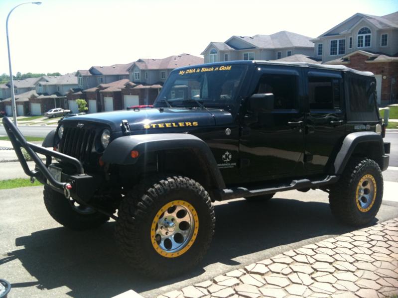

That's what I bought and love it.... I added the Teraflex track bar(it's beefier) and added the stabilizer kit. I got 4" of lift and I'm running 35" tires and an XHD front bumper with stinger.
Wow, that's one mean looking rig, awesome! Just curious, where did you get it from?
