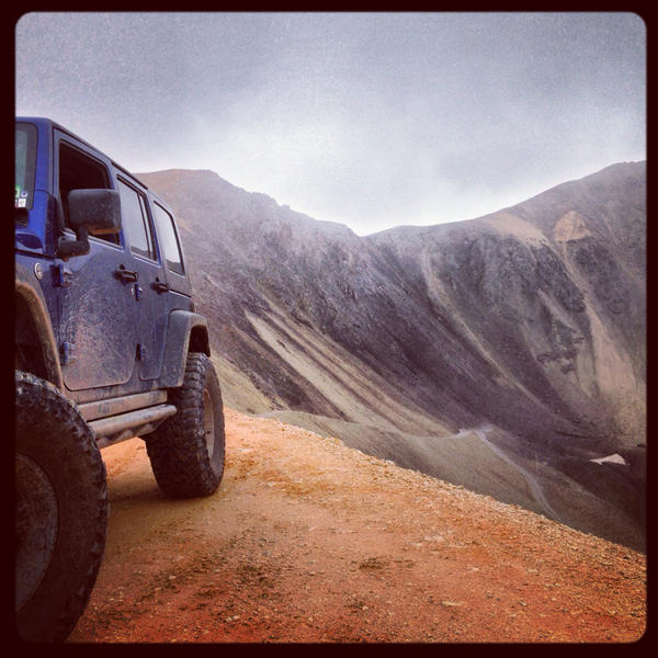

I have the 4.5 AEV with upper/lower front Rock Krawler arms, stock arms in back. I have Toyo MT's in 37. I took it all over Telluride/Ouray trails except Black Bear (was raining) and Moab and it never missed a beat and drive a family of 5 back home to Dallas.

Have any pics of your rig you care to share? Looks like you are running factory flares like I want to as well?
Also, since you are running adjustable arms, did you just remove the brackets that AEV uses for the factory arms? Everything I have read is AEV has their systems tuned to work in unison with each part, so it seems doing so would potentially create some distinction. Why did you choose to go this route? I'm just curious - you seem to be happy with it so I am intrigued.
