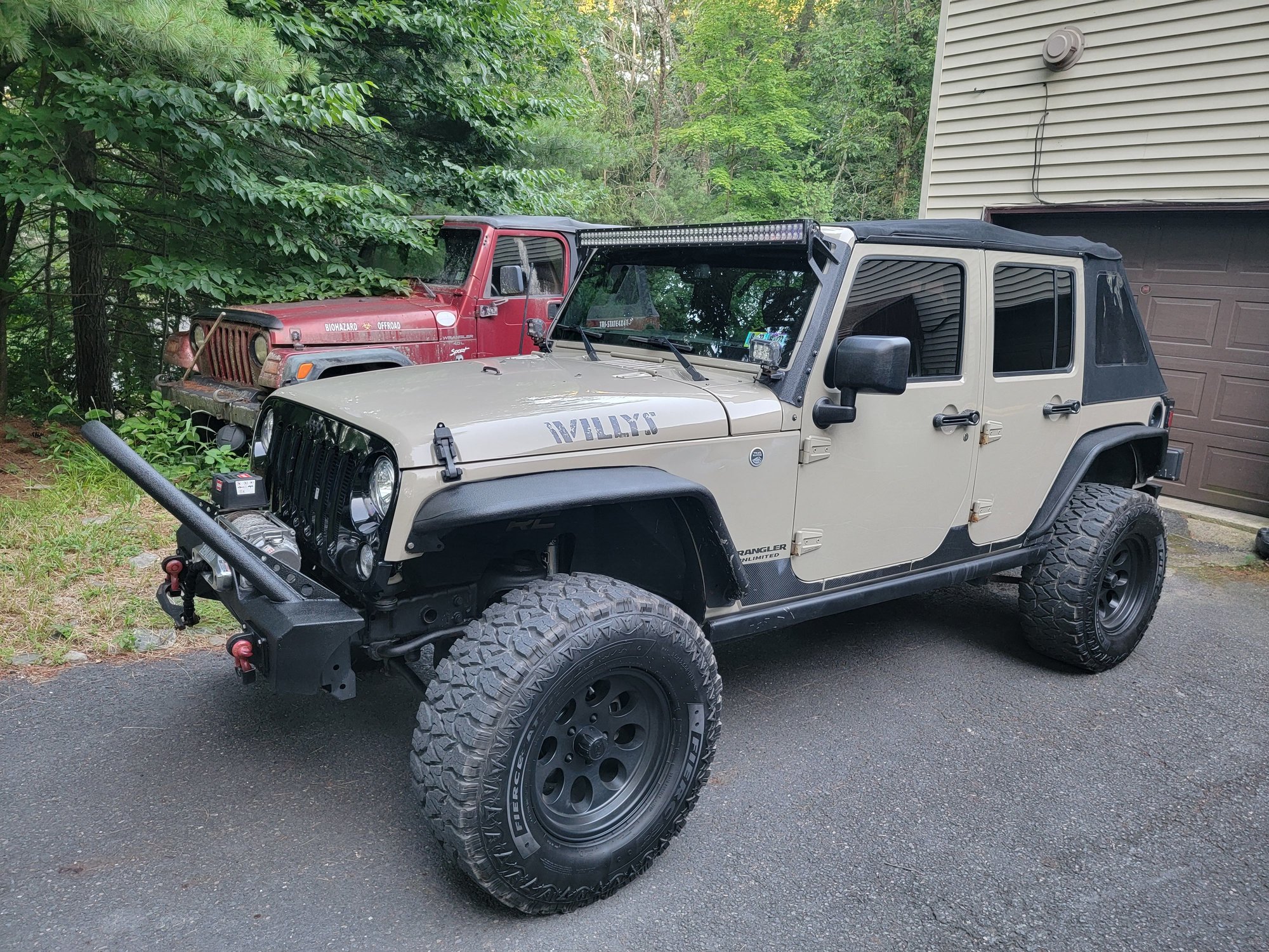

Is that the jeep in your avatar? it's hard to see what is on there now. You have rocker armor and is that a PSC slider?

Yes, that is the jeep. The rocker armor is just carbon fiber stickers(not added by me) and i am not 100% sure, but i believe that the sliders are rubi rails.

Yes, you have a body lift there it appears. That extra puck on top is not factory. That could impact some body-mounted sliders. Some things like rubi rails bolt to the pinch seam and underside of the tub. Other things will bolt up to the underside of those body mounts which would leave a gap between the body and where the slider would typically fall. There are also things like PSC brawler rockers (or similar) that would not be compatible as they mount to rocker armor on the body AND the underside of the body mount bolts. Not many people run body lifts these days. Unless there is some reason you need it, I'd remove it.
