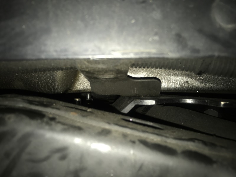

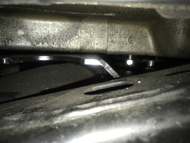

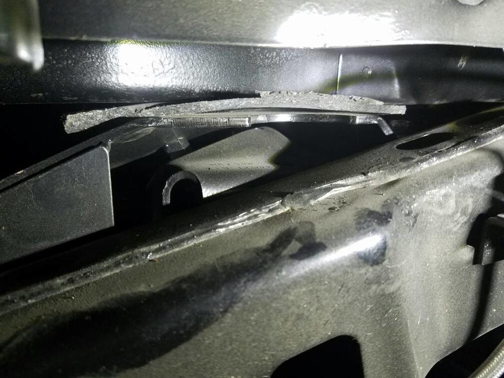

I installed a set of front and rear lcg evo coilovers on my jeep and when hitting some bumps noticed a loud thud in the rear. Sat in my trunk while someone driver and determined it was something hitting the tub. Without hooking up a g pro to watch I'm pretty sure it's the upper reinforcement brackets. I'll post pics of how close mine are but was wondering if anyone has the same issue or not. I did buy the kit used so idk if it's possible that the may of gotten bent somehow but if anyone is running the same kit and can post how close there's is to compare it would be appreciated. Idk what other solution I have then either putting a piece of rubber between the cab and bracket or getting a body lift
which I was trying to keep my height at a minimum.
