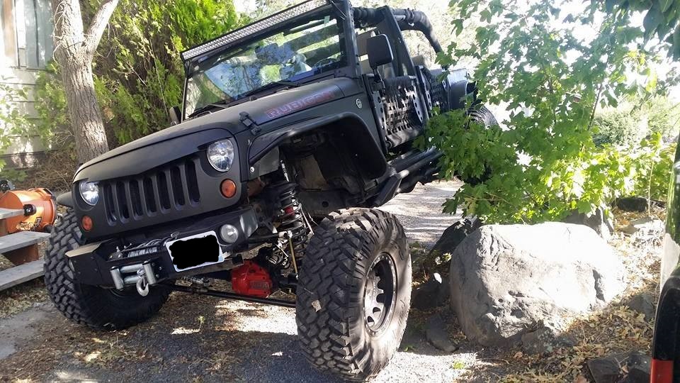

Howdy guys!
So I am collecting parts for my drive-train and axle swaps and wanted to get some ideas from you guys.
I already have a couple shaved 14 bolts and have a buddy who gets front super duty ball joint axles for $400. I was thinking about getting the Artec brackets ( JK 1 Ton Superduty Front Axle Swap ) and welding them on. I would be into it a little over $800 since I have most of the other stuff laying around (Lockers, hubs/flanges, Etc). Now the issue is no ABS, is there a way to get the super duty and 14b to take the ABS senor and work?
I am also trading some stuff for a LS 6.0 motor complete with harness, computer and everything it needs to run (Only 25k miles on it). I was planning on keeping the jeep computer also so I could use ABS, t control and the stock gauges but if there is no way to get the ABS going, I might as well just ditch the factory ECU and gauges and go with some after market gauges.
I am still looking for a transmission, prob going with the 4l80. Tcase I am not sure what to sue yet, but I do have a bunch of 205s and a NWF titan blackbox doubler laying around that could be used. I would like an atlas, but not sure its worth the money when I already have a titan blackbox and 205, and IMO the 205 is way stronger, specially with the upgraded NWF titan output shaft, but 205s do weigh more.
Whats your thoughts on this?
