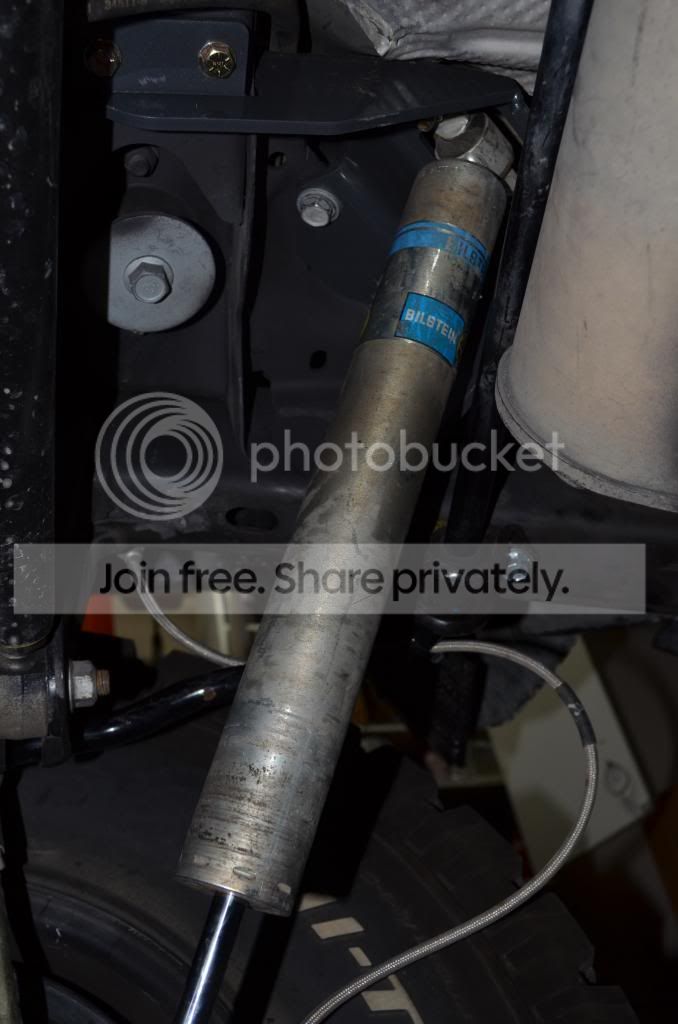

Default Making a 3-link more road friendly
Thanks for the input, didn't think about firming up the shocks. Or possibly more reactive.
Bilstein Shocks, don't remember the exact model number
How much will that sacrifice ride feel? Live in New Orleans, so everyday is like running the Baja, only rougher.
Obviously it is a Jeep so it ain't a caddy.
Old Feb 17, 2016 | 11:35 AM
Smashboogie 4x4's Avatar
Former Vendor
Joined: Oct 2012
Posts: 1,615
From: Newton, NJ
Doesn't look like those are able to be charged.
