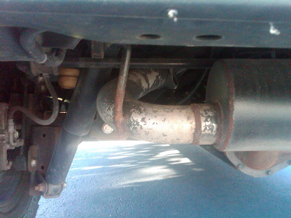

If you are considering MBRP Black. You may want to think again. I installed mine in March and by April it looked like this. Street driving only. No off road and probably about 1k miles.

Old Sep 14, 2010 | 05:20 AM
Sinkic's Avatar
Joined: Jun 2009
Posts: 600
From: Innisfil, Ontario, Canada
thanks i was thinking about getting this. i wonder is the chrome is any better?
Old Sep 14, 2010 | 06:54 AM
robin's Avatar
Joined: May 2007
Posts: 3,931
From: slp. Mexico
that doesn't look too good!! but nothing that bbcue paint can't fix.
Old Sep 14, 2010 | 07:13 AM
opdsgt's Avatar
Joined: Mar 2008
Posts: 1,439
From: Flyover Country
Well, you do live in the Snow Belt. No finish, be it paint or powder coat, is going to last very long in the snow and salt.
Mine looks exactly the same way. I spray it once a year with Krylon High Heat & BBQ Grill paint, lasts another year, repeat. Not a big item really.
I will say, however, the polished stainless variant on my pal's JK down the street from me.... his MBRP system looks virtually brand new and he's had his longer.
FWIW
Old Sep 14, 2010 | 07:46 AM
REALJEEPFAN's Avatar
Posts: 20
From: Lake Villa, IL
It should last more than a month. They are standing by it and taking care of it.

Old Sep 14, 2010 | 03:04 PM
GatorLCA's Avatar
Joined: Jun 2010
Posts: 62
From: Sarasota
Mine's doing the same thing on the exhaust tip and on the first pipe coming from the cat-back. The tailpipe paint stuff easily comes off with just a little bit of water pressure. I installed mine in July.
The exhaust piping seems to be ok, for now. What/who do I need to contact or do to fix it.
Old Sep 15, 2010 | 12:47 AM
Wheelerbob's Avatar
Joined: Dec 2007
Posts: 557
From: Middle river, Md
I had the same problem with mine. I had to repaint with bbq paint as well. I was not real happy with having to paint it after just 4 month's.
Old Sep 15, 2010 | 01:20 AM
Ozzy17W's Avatar
Joined: Apr 2008
Posts: 25
From: Midwest (Kansas)
I had the same problem with mine, looked great when new, but that didn't last long. I ended up getting the "Offroad" stainless version and love it. I also bought some stainless polish from Borla (I think I paid around $20 bucks, but it'll last a long time) and her give a quick shine now and then. Still looks like new and sounds fantastic.
Old Sep 15, 2010 | 03:45 AM
IcyFridge's Avatar
Joined: Nov 2009
Posts: 2,737
From: Rochester, NY
I bought the alumnized version and its been like 10 months now. Still looks like new. I hit it with BBQ paint ONCE and it has not flaked or rusted.
Let's see what happens this winter... I will hit it with another coating of bbq paint before the salt hits the road. Hard to see in the picture, but you can tell its in fantastic shape.
