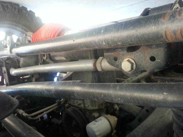

From drivers side

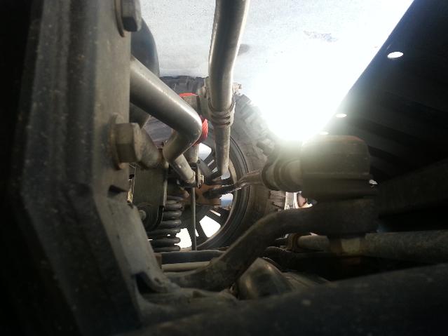

From passenger side
Seem to be a little off from parallel but yes it did fix bump steer problem. Someone did mention like a bump sway that they notice. This is how I would describe my jeep handling now.

Originally Posted by Wrangler22
From drivers side
Attachment 550269
From passenger side
Attachment 550270
The pics are upside down so its hard to see. I think you are confusing "bump steer" with something else? If they are not parallel,the farther they are apart the worse it will be. They need to travel on the same arc through the suspension travel.
I was having issues when driving down the road and hit a bump the steering wheel would jolt either to the left or right. Is that bump steer? When I called 4wd they told me that's what it was and I needed the RE track bar to fix my problem.
yea that sounds like bump steer.

That does sound like bump steer. If you like the way it drives thats all that matters,but these don't look parallel at all to me. If the drag link was in the top bolt hole,which is the stock location,I think it would be better. I could be wrong though.
