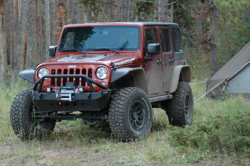

Post 3.5" Game Changer ARB
Lift is on and tested. So far so good. Instructions need updated, but was a fairly easy install. A few things that could have went better. No instructions included, Missing hardware, No mention of replacing front brake lines or routing behind shocks , Rear bump stops are not what is pictured or talked about in instructions, Controll arms that were claimed to be preset for 3.5' were not set or even the same side to side.
Once lift was on and alignment done it was time to test. This lift gave me 4.5". the ride is pretty rough but the handling is awesome. Wash boards will rattle your fillings out. The flex is great, and overall im very pleased. [Click image for larger version
Once lift was on and alignment done it was time to test. This lift gave me 4.5". the ride is pretty rough but the handling is awesome. Wash boards will rattle your fillings out. The flex is great, and overall im very pleased. [Attachment 574321ATTACH=CONFIG]574321[/ATTACH]
And one more thing I will bitch about: The sweatshirt I was promised with the lift never did show up! OK im done complaining. Now im going to use and abuse.
Are you sure you bought the OME shocks? They're one of the best riding shocks out there.
Yes I have the OME shocks. I ran them on my last Rubicon with a Rubicon Express lift and loved them.. These are stiff, maybe they will soften up with more miles.
My ride is very stiff as well. Will be interesting to see what it feels like when I mount my rear bumper and tire carrier and the spare.
Too much air in the tires maybe? How much psi are you running?
