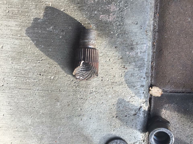

Is your current view for or against? I'm really looking to added for extra insurance. Two buddies with 35s have had steering boxes start leaking bad recently so it's fresh in my mind.
Against. Puts all the stress on the steering shaft. Just spend the $1000 and get hydro assist. Here is a pic of a club members steering shaft. Broke on the trail. Been a total mess and now he's out $700 for a new box.
<img src="https://www.jk-forum.com/forums/attachment.php?attachmentid=619774"/>
Damn that sucks. I never even thought of that. Hydro isn't really in the mod budget, and I didn't think it would be necessary with 35s. But now it another thing to think about...risk no brace and failure or brace and failure haha

It is not weight, but leverage. 37s put way more leverage on the steering. Keep in mind, that steering boxes aren't shearing off the frame or blowing shafts cruising down the road. All of the instances I am aware of were in cases of high stress, such as crawling rocks or Moab where there is a ton of traction. I've always wheeled the same stuff (rocks, rocks, and more rocks). When I had 35s, I could turn them in the rocks for the most part. With 37s, not a chance. The proper technique without hydro is to bump the Jeep forward and back while turning the wheel a little at a time. Just won't work all the time and I've had to be winched out of obstacles solely because I couldn't turn the tires. And now I have hydro assist (although I also went to 40s, so wasn't really an option).
As noted, the number of catastrophic failures is minimal. Just be aware if you are leaning into the wheel when your tires are jammed in between rocks. Leaking boxes is also an issue and a brace will help. With larger than 35s, a brace absolutely tightens the on road steering.
In summary, hydro is best, but most won't go that route. To brace or not to brace, is a personal decision.
