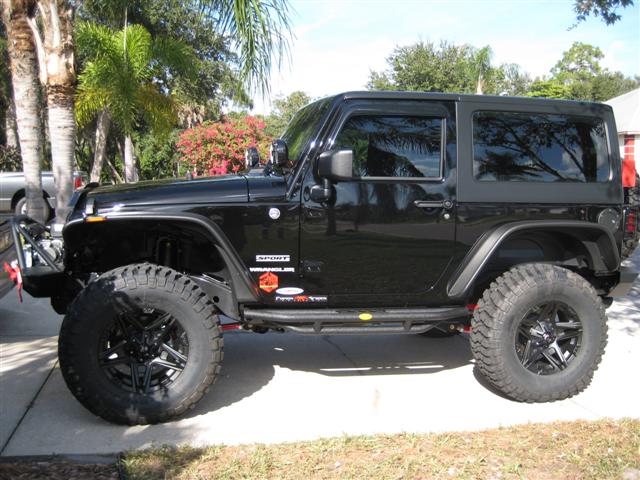

Post-lift stance. The 2.5" GCL gave me 3.25" in the front and 3.5" in the back. The 35x12.5x17 KM2s added an additional 1.25" in the front and .75" in the rear because of the heavier spare. Total lift combined is 4.5 front and 4.25 rear.

Stock bumpers?

Nope. PSC front brawler mid with brawler bar bumper with 8k winch and psc rockbrawler 2 rear with tire carrier and full-size spare.
