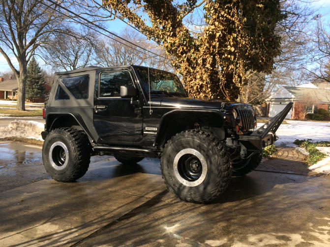

I run the 2.5" with Overlines and 37s and it looks good. I wouldn't want another 1".
Attachment 539887
Jeep looks sweet!! I'm thinking the same thing. That extra inch may be too much especially if I get a little more than 3" from the MC. My dog can still make it, but I don't think he will be able to forever. Plus 2.5" with FF and 37's will be plenty.
Thanks! While not a good data point, I'll note that I am at exactly 2.5" of lift in the front and about 2.8" in the rear. I have some weight, but nothing crazy. I was expecting over 3". You won't know until they're on, but figured I mention it. The two door coils are still pretty new, so maybe the spring rates are a little too low.
There's enough data points on the 4-door coils though, so you should be able to get a good idea.
I'm all for less lift, so I'm very happy with how the height turned out. You'll have no issues clearing 37s with flat fenders and 2.5". In the off chance you decide you want the extra inch, you can probably get a price cut from MC and sell the 2.5" coils for the same amount and be out nothing. Plus, you won't have to worry about driveline angles as much, etc.
