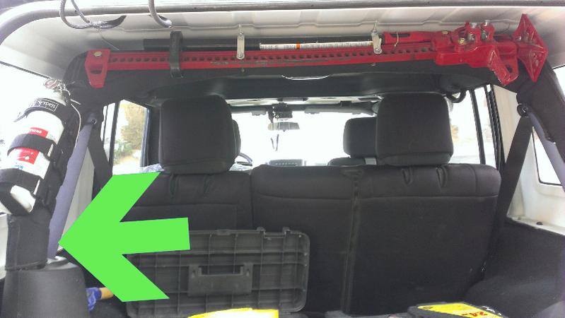

For the green arrow pointing to the roll bar under my fire extinguisher is a place to mount a hi lift. Quadratec sells the brackets for it, I think its around $85 or so.

<img src="https://www.jk-forum.com/forums/attachment.php?attachmentid=430764"/>

Quadratec Exclusive JK-HLJM - Sport Cage Hi-Lift® Jack Mount for 07-10 Jeep® Wrangler & Wrangler Unlimited JK - Quadratec
Has anyone come up with a better idea than this?
I too don't want hanging out on the hood nor vertical on the rear bumper. I have the TrekTop NX and some of the interior mounting ideas simply don't work. I attached a link above that shows the "Sport Cage" hi-lift brackets but am not paying $85 (don't forget about shipping) for this. I am planning on making a similar bracket out of 1/8" 6061 aluminum and coating it in Plasti-Dip.
The way this bracket is set up, it will now interfere with the TrekTop and will function very well with a hard top on also. The only downfall is that when you go to get gear out of the back, you will have to go around the jack.
