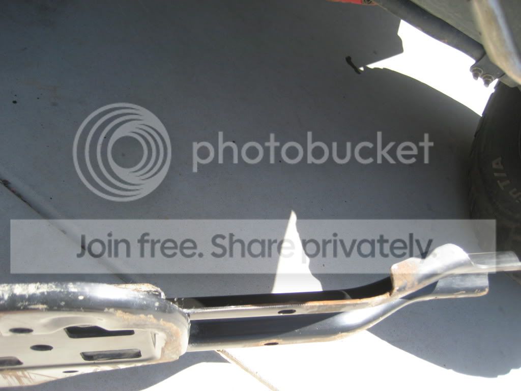

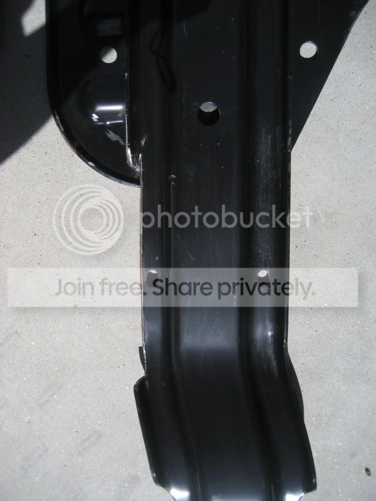

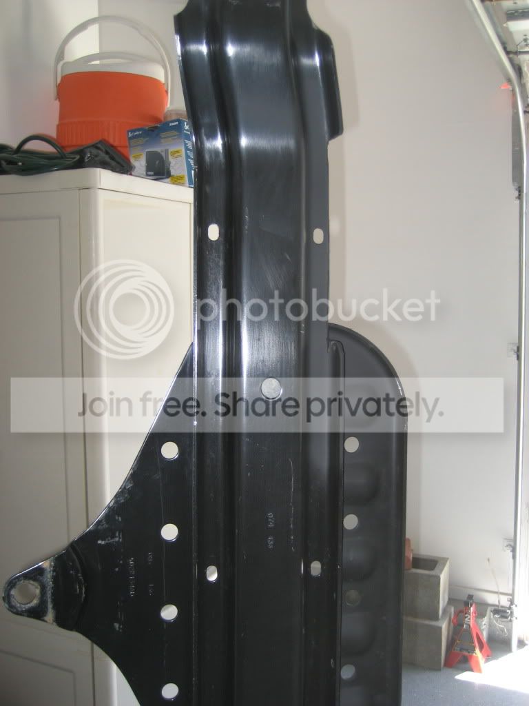

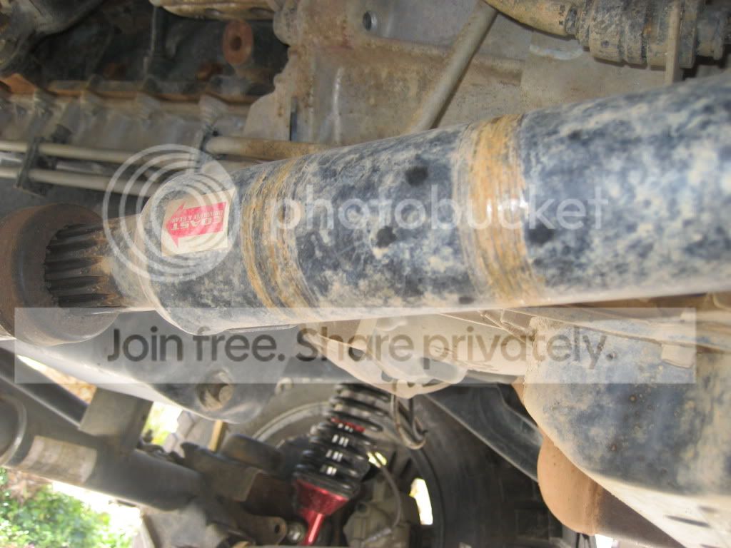

Okay even after market DS you may be experiencing flex issues if you are running the 1350HD shafts like we are and your DS hits you only need to make some slight adjustments to the skid to fix the issue. Here's some pics I snapped and I could do a write up if needed but like the OP says it's pretty much self explanatory
Tranny skid notched
front DS damage
Cleaned up and touched up with the rattle can to help prevent rust!
