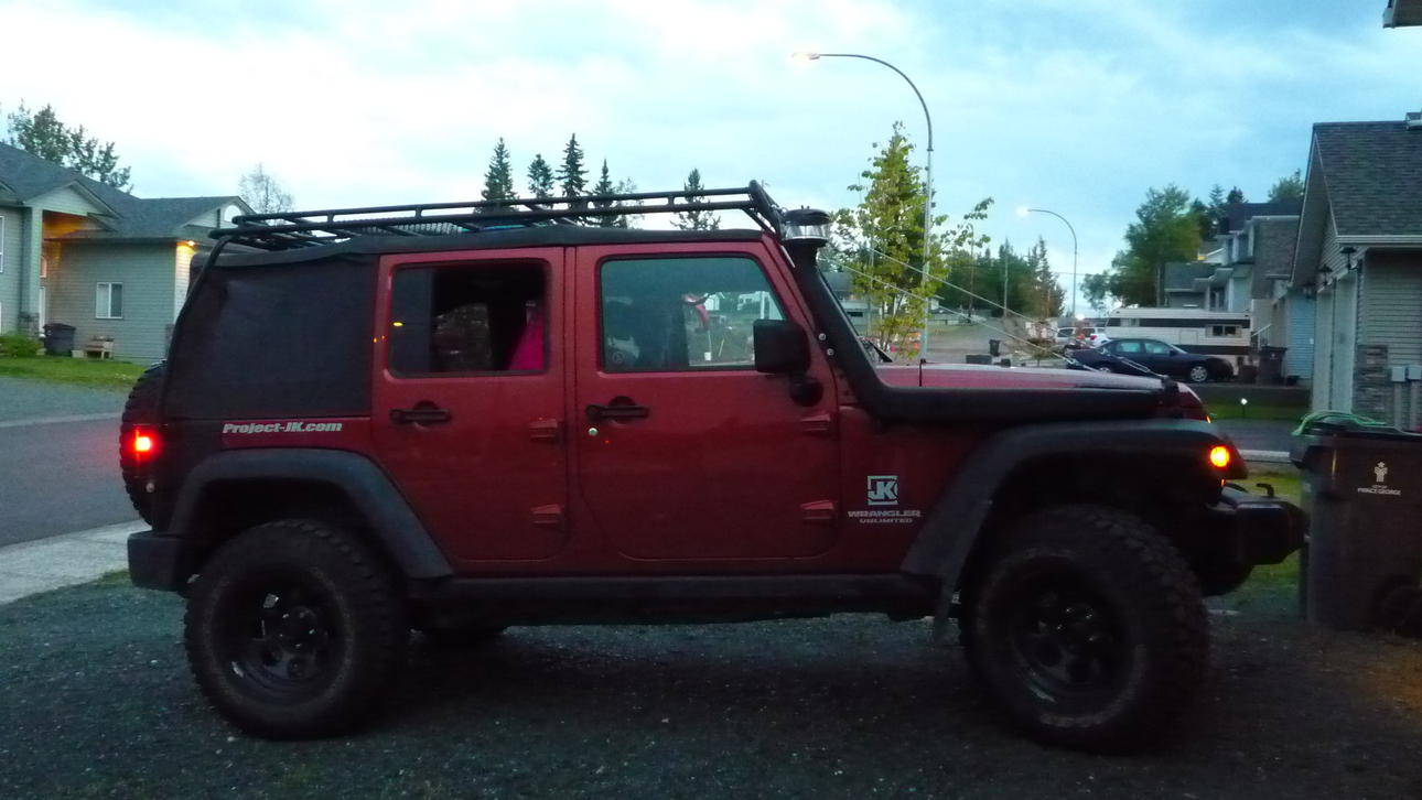

As for a visual - here's my Rubi a while ago. In this pic I'm running 619's in the front (to help with ARB bullbar) and 617's in the rear. I'm still on Rubi 32's here but you could go up to 33s.
btw Northern Wrangler -> sweet rig
