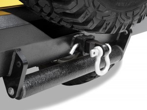

While I highly appreciate Metal Cloaks' suspension and other parts, I'm much less enthusiastic about the design concept of their rear bumper & tire carrier.
The hinge is located at the corner, where it sticks out, exposed and vulnerable.
The same goes for the support beam, and the lock at the other end.
The bumper should be solid and able to survive hard hits by rocks or whatever.
The moving parts should be protected above the bumper, and not the outer-most part that that gets hit when, say, the Jeep slides back against a rock, or rear-ended in an accident.
Double bearings are far from being unique to Metal Cloak.
My less expensive Bestop HighRock rear bumper & tire carrier has a very massive double-bearing hinge, in fact stronger and better made than the Metal Cloak hinge.

However, this is the one:
The install was straight forward, good fit, no problems.
The tire carrier is connected to the rear gate, so opening the gate opens the carrier - no need to open them separately.
I have it for about 2 yrs of DD and offroading and it works just fine, no rattling or noise.
It came with a roller, which rolls over rock steps, instead of dragging the bumper over them. I tried it, it works nicely, so I left it on.
There are those who don't like it and cut the 2 D-rings off.
I wasn't aware of the roller when I ordered the bumper, and am not sure if it comes with it, or is the roller an option.
BTW, it also came with a LED third brake light that sits in the middle of the wheel.

This is the one I have:
Bestop
