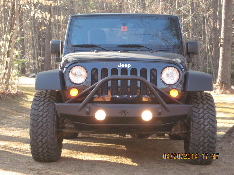

Removing the flares wasn't hard at all, just time consuming if you don't want to break clips(which you will...haha)
As far as prep goes. I washed with dawn dish soap and scrubbed well. Once dried, I wiped down with mineral spirits and a clean rag. I didn't bother sanding since these flares have a decent factory texture for the bed liner to bond to. The bed liner applies easy, just don't glob it. Again, I did two solid coats and baked them in the hot sun for the afternoon to ensure they cured.
Regarding your question about cleaning. Yes, they tend to stain more so than I thought in between washes. Not from rain necessarily but mud puddles. I use a mild scrub brush to clean during washes.
I definitely recommend it. It made my 2011 look newer. I was so sick of the blotchy faded bumpers and flares. They also seem to take hits pretty well, I've rubbed my bumpers/flares on packed red mud/rocks, trees, etc. No peeling or "damage".

In regards to the cleaning, i fully expect them to "hold dirt" between washes but i guess my question is "when you wash them, are you able to wash them so they are clean" or is it one of those things that once they get dirty, you can never clean them so they look "new" again.
Thanks again!
ya that looks really good. I have a new rear bumper/tire carrier showing up tomorrow. Its powder coated as is but i am strongly considering giving it a rustoleum bed liner job before installing. I just like the color and texture better than the powdercoat. My only concern is it being a PITA to get the bedliner clean when it comes time for a wash. I like to keep my jeep nice and clean unless i am getting it nice and muddy

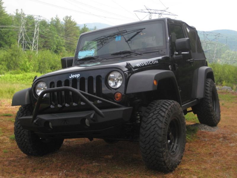

it washes up ok ,if you use a soft bristle brush or just a wash rag and dawn dish soap I use lol ive never used car wash soap or anything . I would suggest before you just spray paint it . Wipe it down with alcohol (not ) but beer might work try to use rubbing alcohol
then hit it with a couple of coats of etching primer from rustoleum too found at wal mart . It will look like this (see photo) then give it two or three coats of bed liner ~ if plastic im not sure the lasting performance of bed liner on plastic its a perfect match of factory plastic fenders with the rustoleum bedliner , good luck with your project .post pic when done
