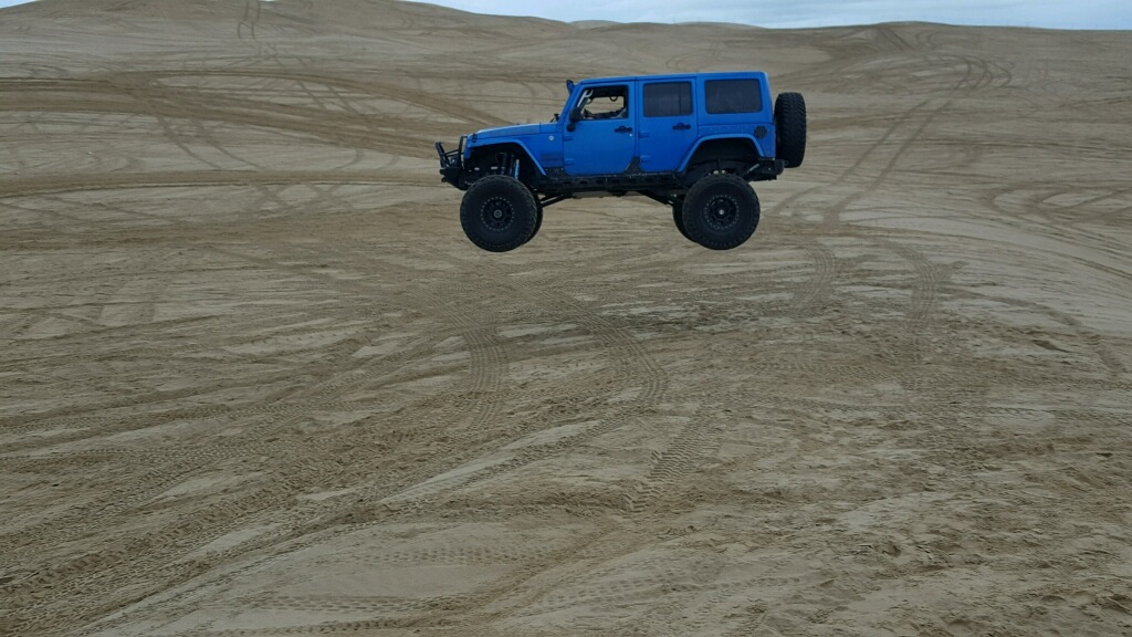

I will throw one anecdote at you, then I'll put my soapbox back under the table. The owner of Trail Jeeps built a hemi powered, Double Throw Down/Evolever Dynatrac'd seizure inducing bright blue pile of awesomeness on 40" Nittos and ran it for years. It's been everywhere. It was awesome. It was stiff on the road, it required a lot of servicing. It also allowed him to do things like this: Click image for larger version
ID:	668886, which is cool. He sold the Jeep, named Jefe, bought a 2016 and installed an off the shelf 3.5" JKS Spec suspension, fixed length rubber control arms with Rubber bushings and 37's. He runs the same trails, drives the same distances and does the same silly man child like things off road as he did before, granted not quite as fast, and maybe having to try a line twice, but the Jeep is reliable, rides and drive like an OE type set up and is hassle free.
