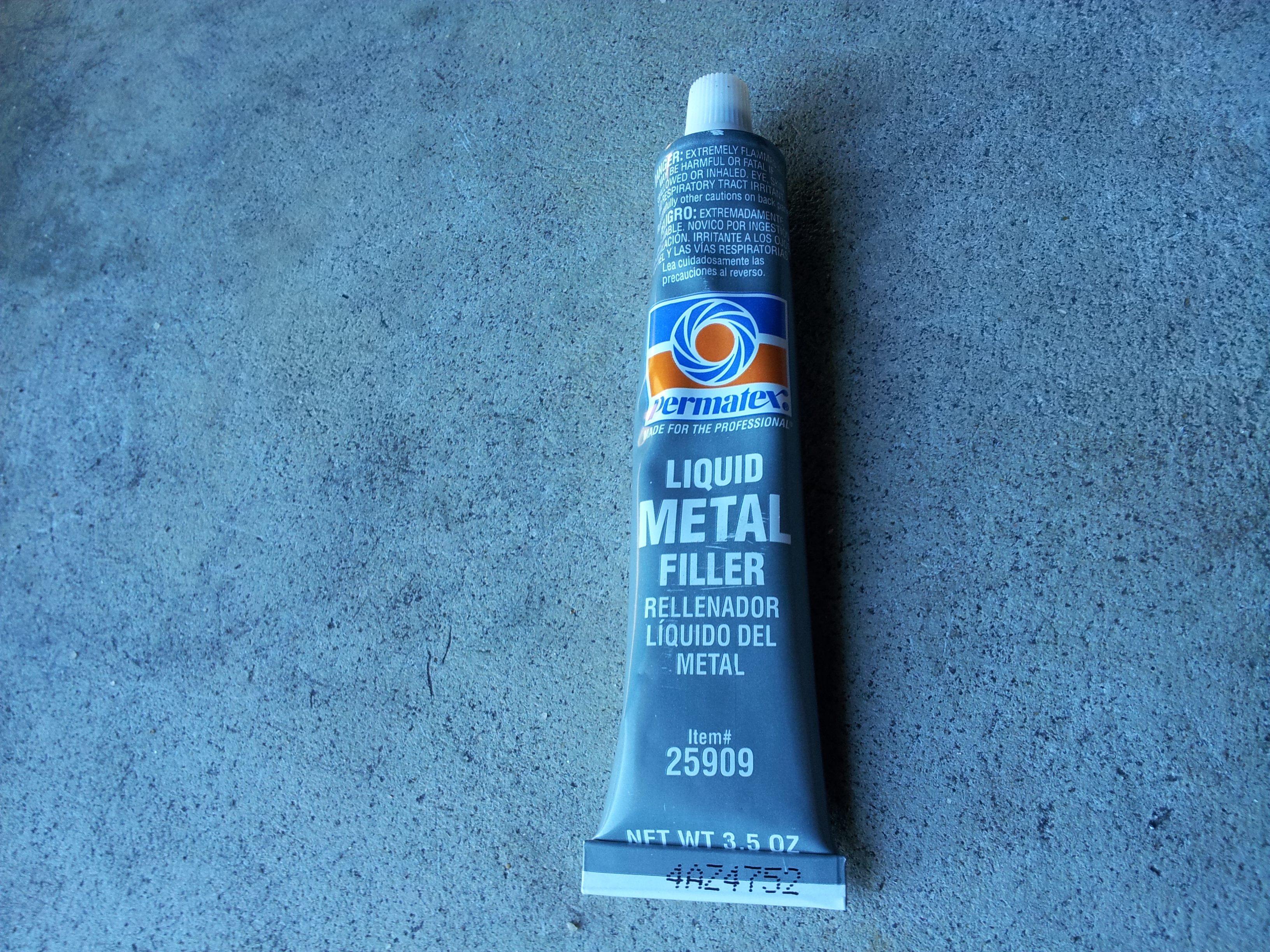

2 Attachment(s)
Attachment 616608 This worked perfect. Used tape to keep it in. It will dry preety fast, sand prime and paint.Attachment 616609Sawzall works best with a metal blade if you have one.
