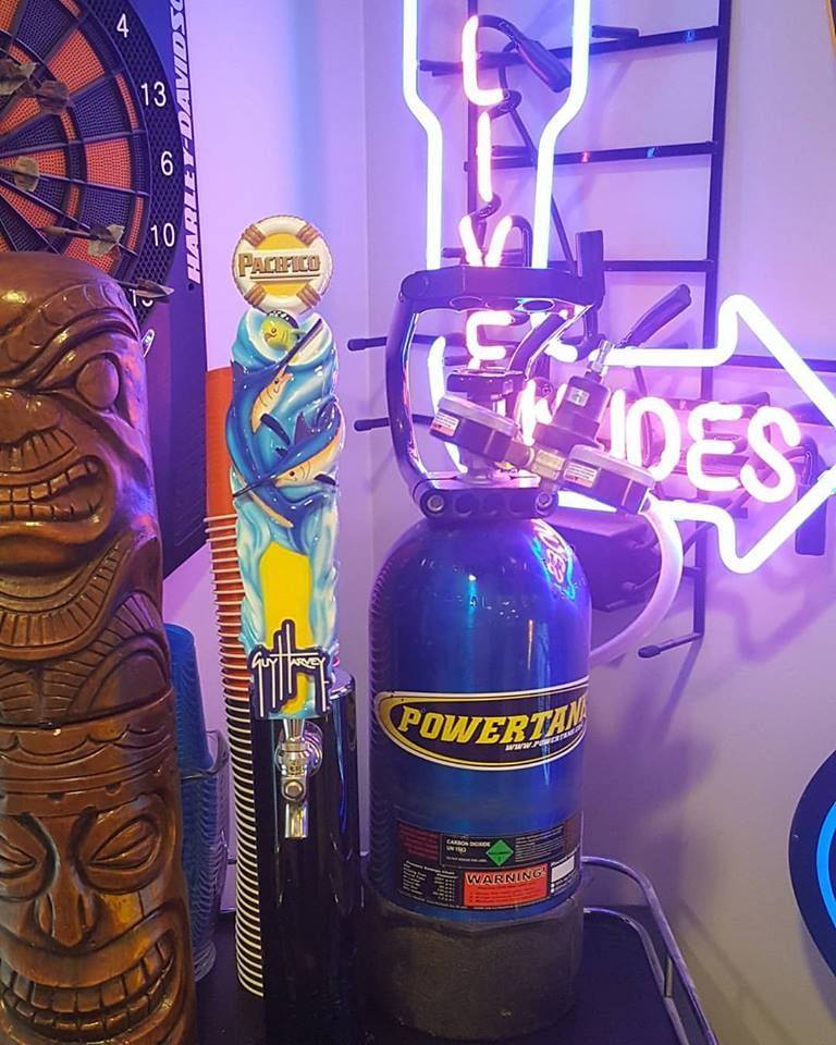

Throw a lunch box locker in the front...... yes even a Dana 30.
Hell you can wheel that and have a lot of fun. It will double or
more the trails you can go on. You need to go with a selectable
locker in the rear in my opinion. I personally like electronic
lockers better than air lockers. I ran Eaton E-lockers for years.
I also prefer using a CO2 tank....more versatile for other uses
around the house etc...

Two is one, one is none. I've got a tank as well. Came in handy around the house when the CO2 tank on my kegerator ran out. I've also got fittings to plumb the tank into the air system on the Jeep to run the lockers in the event I have a compressor go down, which I've had happen, even with the twin ARB unit, while I was in Moab. ARB was awesome with support and warranty, but a backup plan is always a great idea as things break, tanks go empty, shit happens.
