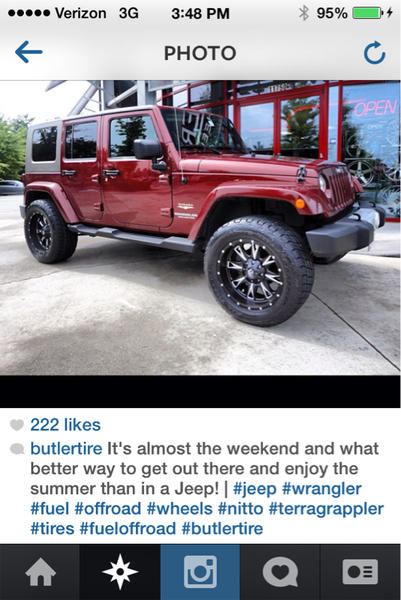

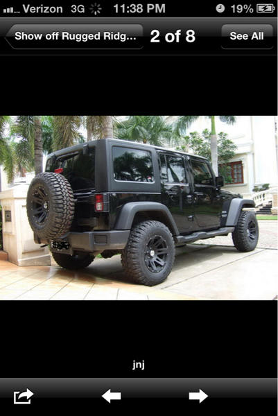

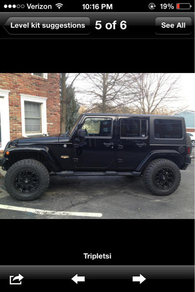

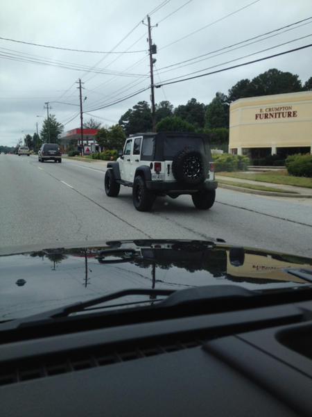

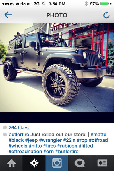

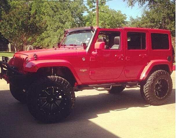

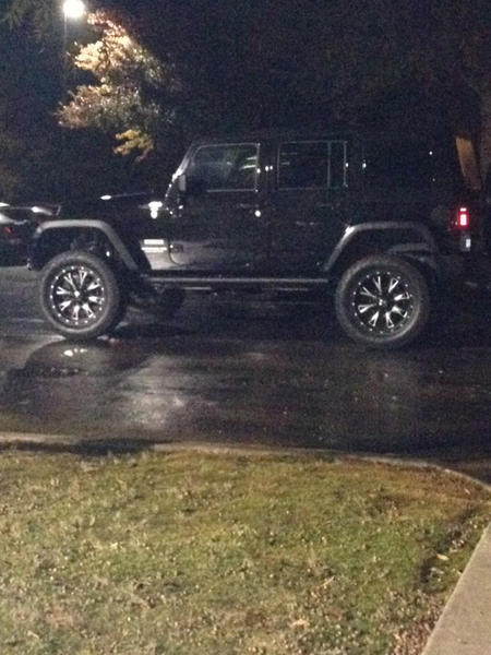

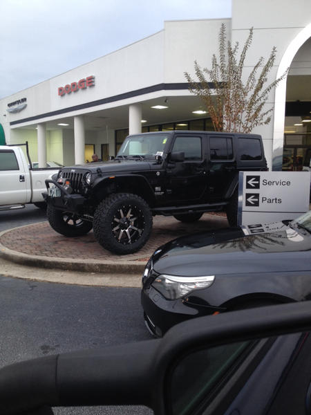

Thanks y'all!! Well I don't really understand the gearing situation now haha and does anyone know of a good, decently priced jeep shop besides fortec and 4 wheel parts in GA and a good 4x4 club in GA? Also, if I did take it somewhere what's a decent price for parts, labor, tax, etc? I called 4 wheel parts yesterday and they told me for a 2.5" budget boost and what I'd need, after I told them what I was looking for, it'd be about $1000 for parts, labor, etc
I will post some pictures of jeeps I've seen that I really like! Some of them I know what's been done, but some I can't tell I just like the look
For reminder- As of right now I want my jeep leveled, good ride, and eventually to put 33's or 35's on it (that's why I've looked at the 2.5")- it's my every day driver and the only off roading is dirt roads and maybe a little mudding
Pictures of jeeps I like!

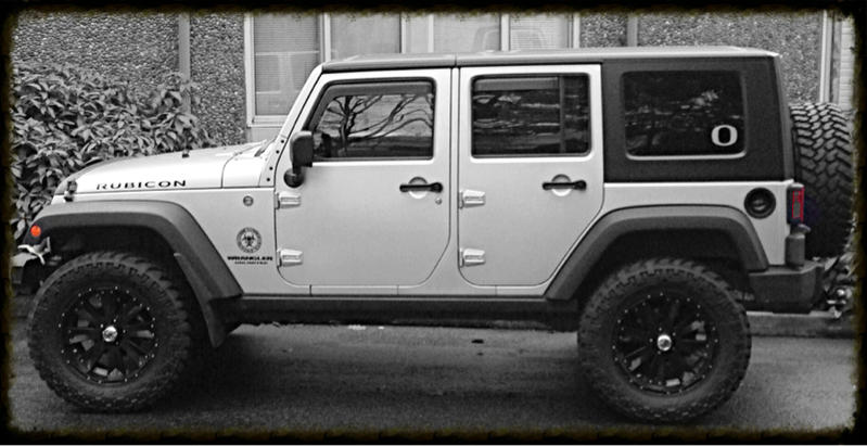

I am running a Teraflex budget boost with 35's on mine now and it rides great. I did upgrade the shocks to a set of adjustable Rancho 9000's and ditched the shock extenders.
Alright cool! You're jeep looks good too

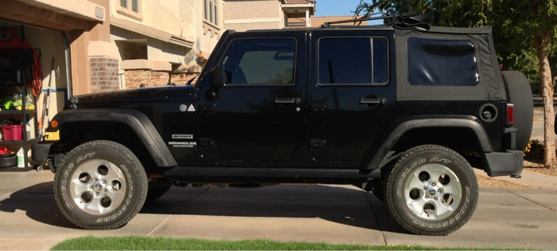

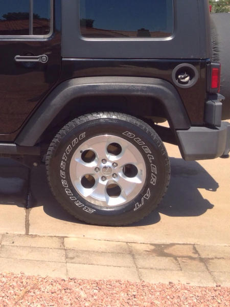

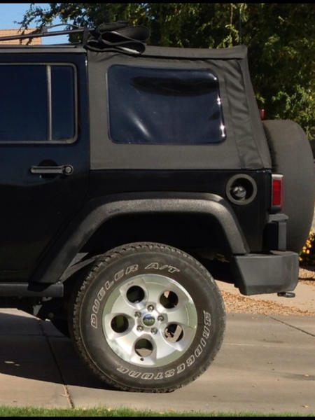

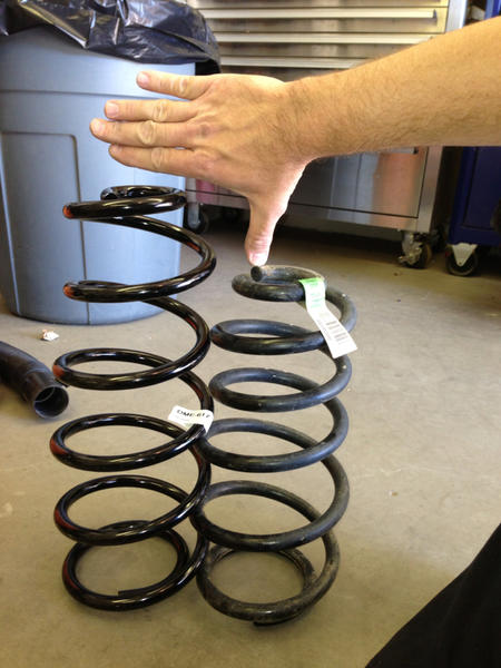

This is what I did to my 2010. I changed out the shocks to the Rubicon ones and the springs are Old Man Emu's. The JKU sits about 2.5" taller and I am using wheels and tires from a 2013 Sahara for the time being. I will eventually be putting back on my black rims once I get money for 33" tires to put on those.
You can always find Rubicon take off springs and shocks on Craigslist and have people from the forum help you change them out for you instead of spending a lot of money.
My buddy and I both wrenched on my Jeep and I only spent less than $500.
The last 2 pictures shows the additional height I gained from the rear springs.

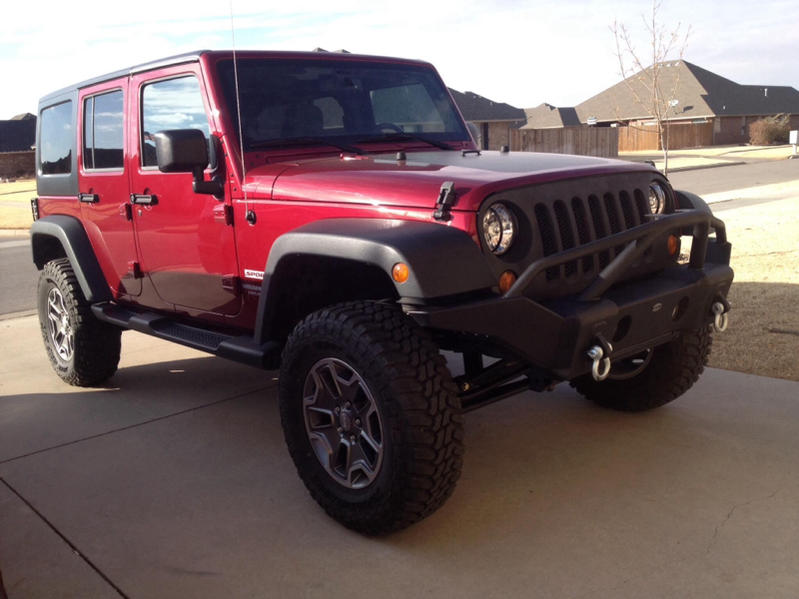

I recommend a TeraFlex leveling kit for your needs, it lifts the front 2" in front and 1 in back giving you a level jeep with 1" of lift, looks nice with stock wheels and tires. About 160$ and 3 hours to install. With basic tools.
Since then I have also added 33" tires on Rubicon wheels with 1.5" spacers and 10 anniversary rubicon springs for a total of 2.75" of lift.
