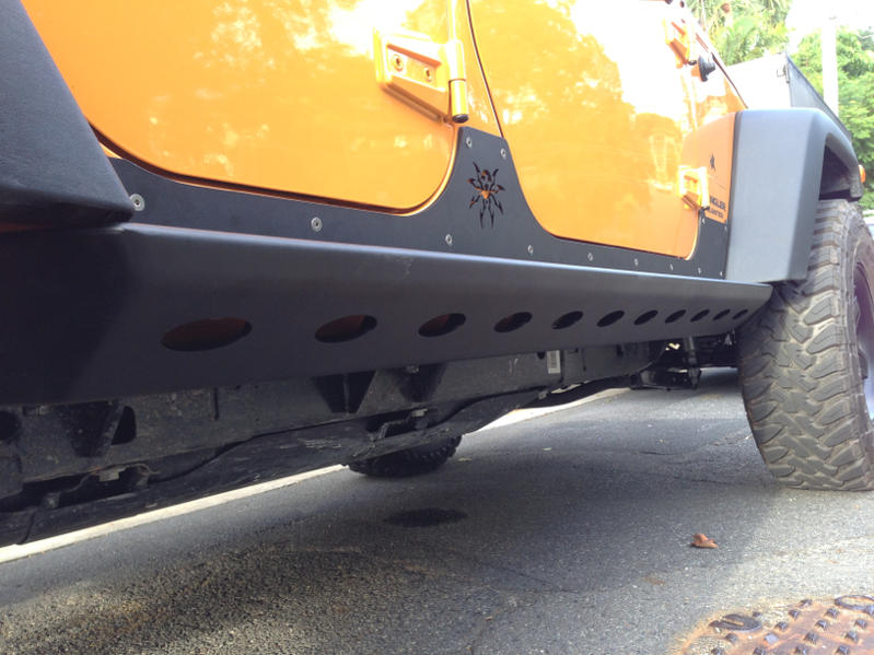

1 Attachment(s)
I love mine
Attachment 422070
