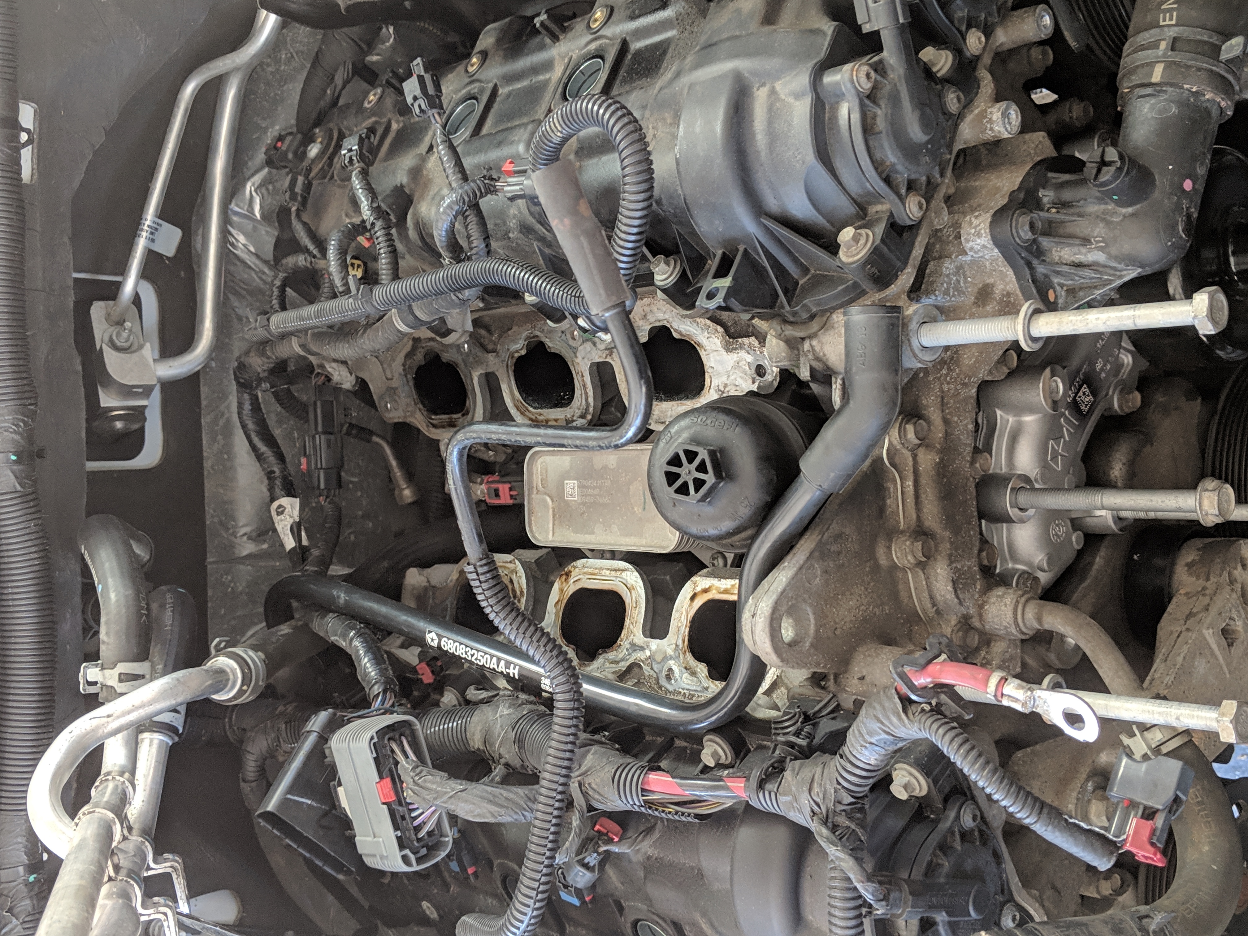

Took my buddy and I all day Saturday to install, this included.. replacement of water pump, removing intake manifold, cleaning ports of intake, new spark plugs, installing hardware for SC, bigger injectors, new tensioner and relocation, bracket for power steering/SC, intercooler, tubing, cutting some plastic off radiator fan/around grill, installing Diablo tune preloaded on device A Piller pod and gauge (Areoforce technologies)
The Ripp SC kit I bought included the upgraded pully, xl intercooler, bigger blowoff value,
Also got the Ripp exhaust to go with it. ( Still needs installed)
Next on the list is for install, mishimoto radiator, new houses, basic set of barricade bumbers, spare wheel rack, fenders. Rough country liners, Ripp exhaust, centerforce duel friction clutch
