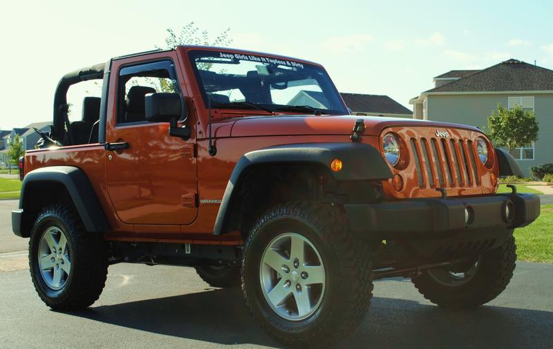

Here is a couple shots of my 08 Rubi with 2.5 Teraflex BB and stock tires.
Stock
Lifted with stock tires and wheel spacers
Stock
