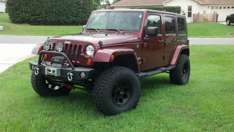

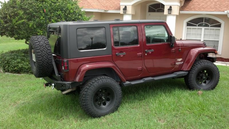

I bought a Rancho 4" Sport Lift (RS6507B) last year during Rancho's annual $500 rebate and, based on the part number in your picture (176436B), those same brackets came with the kit. Those brackets have been in the 4" Sport kit for the last 3 years at least.
Today I would go with the new 3" kit but it wasn't available last year.
To those who say the brackets hang too low, long-arms are just as bad and may by worse for break-over since the long-arm brackets are closer to center.
... Besides, the lower control arms will guide the rocks under those brackets.
Rancho 4" Sport with RS9000XL shocks, 17x9 M/T Classic 3, 315/70R17 Duratracs on a 2010 Unlimited Sahara:
(BTW - caster with brackets after lift was perfect with stock control arms.)

The main reason for going with 3" over 4" is stability. If you don't need the extra inch for fording streams and mud holes, being an inch shorter gives a lower center of gravity.
Before the new 3" kit (RS66106B) you had to have the 4" to fit 35" tires. That is no longer true. The 3" works fine. Also, the 3" has an inch more down-travel than the 4" since they use the same shocks. (I think)
NOTE: With both the '12 and '13 year models you will need the exhaust cross-over (RS720003) for either. My 2010 doesn't require it.
Installation of the new 4" and 3" is much simpler than last year's kit with the front track bar relocation bracket (major PITA to install and really should be welded in place) and the dropped pitman arm (ever tried applying 185FtLbs of torque sideways?).
