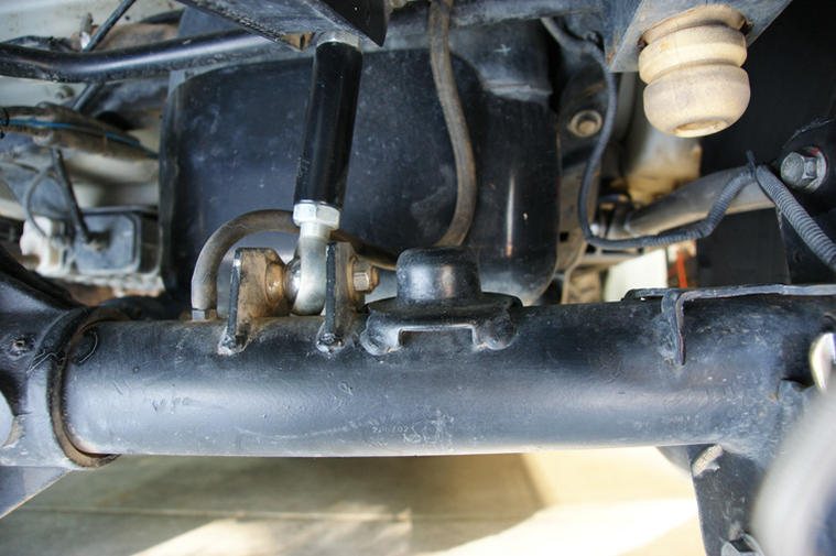

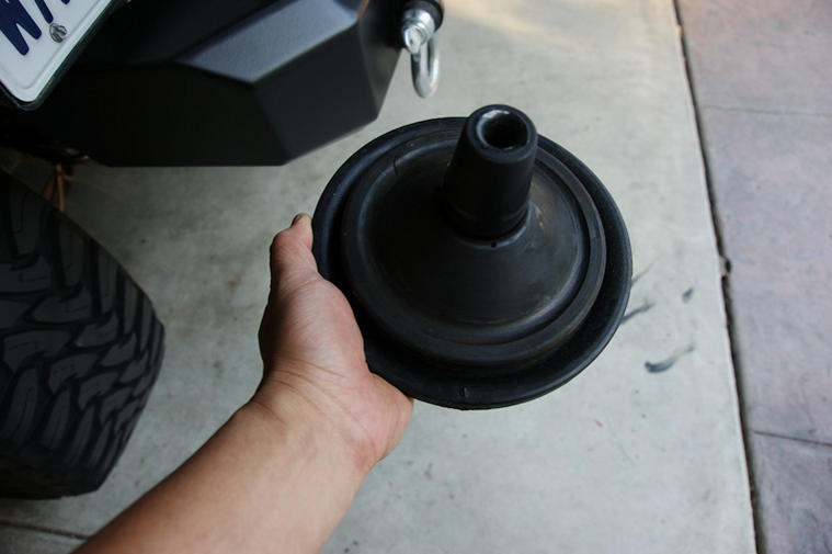

Originally Posted by JRod
Well, respectfully sir, on my 08 Unlimited, as of yesterday, there is an index on the LOWER REAR spring perch. Maybe they are not all like this, but on mine there is. I just went outside to snap a pic, but with the spring in and the weight of the vehicle on it, I can't get a clear enough pic to post up.
if that is truly the case, that would be a first for me and i would imagine this may pose a problem once you have to set your pinion angle. here are shots that i just took of my 07 lower spring perches.....
as you can see, it is completely smooth around the nub and there is no index to be found. does yours really not look like this?
also, here is a shot of the rubber isolator. as you can see, it is completely uniform and there is no index to be found.
ID:	20383   Click image for larger version
ID:	20384   Click image for larger version

I just did my 2007 unlimited X today my lower spring perch is just like Wayoflife's, but my upper rubber isolator is different I don't have the long rubber bumper in the middle, so what I'm going to say here Jeep must have use some different components on some models verses others. When I put mine in, I just looked at the stock springs and put them in the same postion when I installed the new springs. Mine are heavy duties too.
i'm sorry but the rubber thing in the middle is a teraflex spring retainer - i just didn't bother to take it off when i took the photo.
