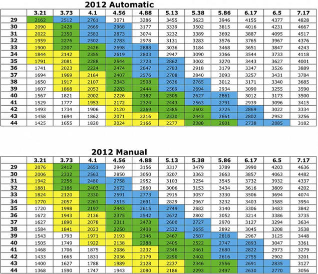

Ok so 2012 auto with 37s your saying 5.13s would be perfect. I was going to do 4.56 cause people where saying with 4.88s at 70 they where almost at 3000
Yellow is minimum, green is acceptable and blue is performance... 4.88s and 5.13s are pretty close, just depends how much crawling u plan on doing vs daily driving...

Originally Posted by Atlacatl
<img src="https://www.jk-forum.com/forums/attachment.php?attachmentid=382033"/>
Originally Posted by chris@offroadevolution
as mentioned the difference between 4.88's and 5.13's is minimal. I would go with 5.13's
